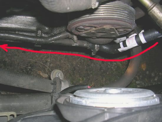

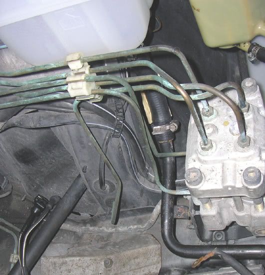

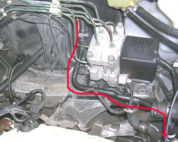

I don't know how your 2.7's reservoir is setup (twinturbosixer), but the one on my FWD '95 has only two hoses.
The overflow (coming from the radiator), and the bottom one you talk about that hooks into the line that goes to the T-stat housing.
Here's some pics so you can have an idea
Click the image to open in full size.
