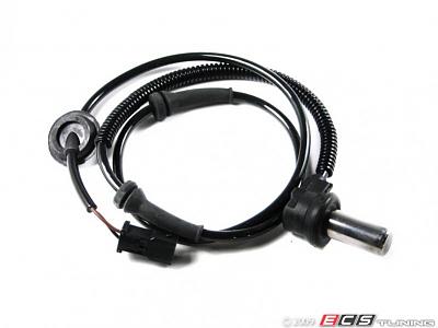

So this is the picture of a ABS speed sensor for my car. As you can see, it is only made out of a metal piece, at least what it portrays here. So, I wonder how the 3mm rule applies to this??
[IMG]file:///D:/DOCUME%7E1/SMILOS%7E1/LOCALS%7E1/Temp/moz-screenshot.png[/IMG][IMG]file:///D:/DOCUME%7E1/SMILOS%7E1/LOCALS%7E1/Temp/moz-screenshot-1.png[/IMG][IMG]file:///D:/DOCUME%7E1/SMILOS%7E1/LOCALS%7E1/Temp/moz-screenshot-2.png[/IMG]
Attached Thumbnails ABS light and Brake Light flashing - vag-com(diy) or shop?- need insight please?-oem-front-abs-speed-sensor.jpg
