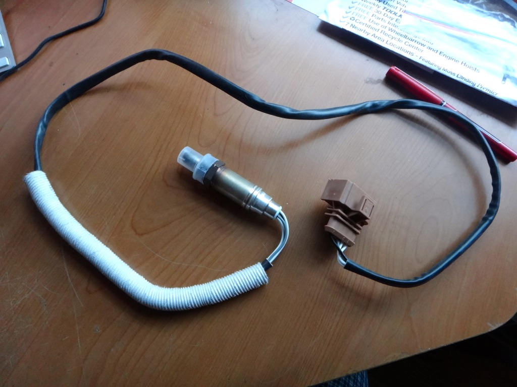

Got my new pre-cat O2 sensor today. Cost $66 shipped from Amazon.
Bosch 13740
Tomorrow I'll pick up the new gear ring for the VSS, once my speedometer is fixed I'll replace the O2 sensor. Then it's back to collecting brake parts.

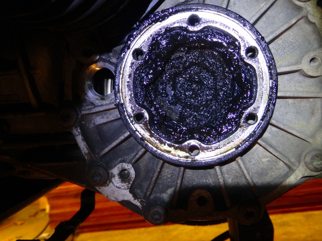

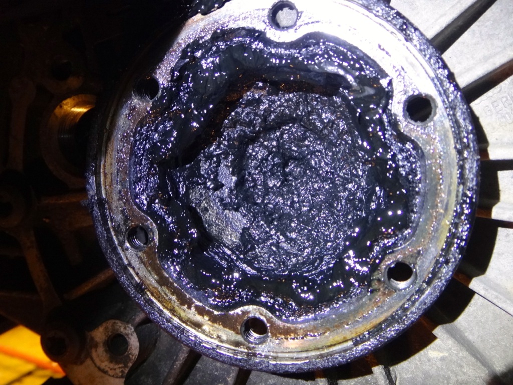

Just pulled the driver's axle and found this, normal?

CV grease is typically grey/black. It may just be your picture, but the grease looks a little grainy. Maybe the grease in there got a little too hot.
While you've got it apart, I would clean out the joint as much as you can and then repack it with new CV grease.

Time is somewhat of the essence, and since I don't have any CV grease on hand I may just throw it back together.'
The part I ordered was 012-409-182-C, the part I pulled off the car is 012-409-182-A. The only difference I see is that the A version I pulled off has a locating tab that the C model doesn't have. ECS' website says the A model has been superseded by the C model so I will probably just go ahead and install it.
Then again I don't want to be pulling the output flange again...let's hope this works. I don't see anything wrong with the ring I'm pulling off.

You can pick up a tub of Moly CV grease at any parts store. If you choose not to grease it, I would plan to pick another time to disassemble, clean and grease both front inners.
