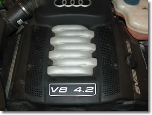

There are two different types of 4.2L engines, ones with timing belts and others with chains like the S4 and the allroad. The A6 and A8 have timing belts. To make sure which engine you have here are the pictures of the different 4.2L engines.
1st. With timing belt:
2nd. With the chain which is the one i believe is in the allroad.:
If you have the latter, then no change is necessary. Just change your serpintine belt at around 80k and you really don't have to worry about anything else, you can change the water pump which is chain driven, but i preferre to wait until it breaks, because it could indeed last 200k.

Allroad 4.2s don't have timing belts. They have a double row timing chain which is located at the back of the engine. The original Audi V8s would not fit in the allroad engine bay so in order to install the V8 they had to redesign the allroad engine using timing chains to make the engine more compact. These never need replacing according to my Audi Service Tech. If you have to replace them you will be replacing the entire engine. I you compare the allroad V8 to that other A6s you will notice that the allroad valve covers are more compact (shorter) than on other 4.2Ls.
I have an allroad 4.2 with 98,000 mile on the clock. I am the original owner, have had all services performed on schedule and by an Audi dealer. In have recently pushed the car to 165 mph on the German Autobahn (had limiter removed) and the engine is running as strong as ever. The Audi 4.2 is a strong reliable engine if properly maintained. It suffers none of the problems that plague the 2.7 turbo. Congrates on purchasing the 4.2 and I hope that this helps.

Just had a look at my 2005 A6 4.2 Avant Quattro and it looks exactly like the timing chain picture so possibly not all A6s have belts
