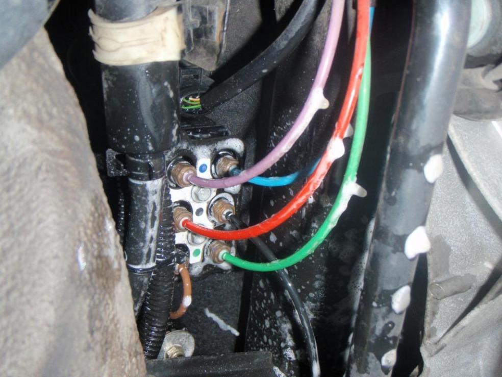

Old 10-11-2008, 01:55 PM
Burnout's Avatar
Join Date: Sep 2008
Posts: 10
It ended up being a leak at the junction box where all the lines come out at the bottom rear of the car. It was the black line and you could not hear any sorta leak.

Old 10-11-2008, 06:19 PM
incrementalg's Avatar
Join Date: Nov 2007
Location:
Posts: 477
Good catch on that. Saved yourself an air spring replacement. My dealer misdiagnosed an air spring leak and relplaced one of the rear springs, but didn't bother to thoroughly check for leaks first. It was one of the lines and not the spring. Doh!
Old 10-12-2008, 04:45 PM
auditech79's Avatar
Site Moderator
Join Date: Feb 2007
Location: Nor Cal
Posts: 9,004
Thats good you caught that, i have never replaced a rear air spring on an allroad, just the fronts. I'm gonna add this in my sticky post.
