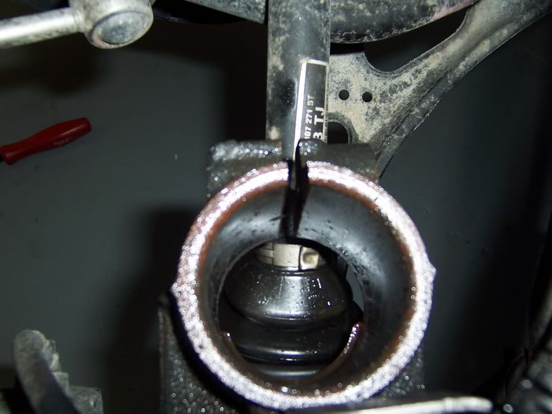

I'm trying to install Euro S-Line springs into my 06 A3 2.0T. I've done this before on several cars, so I'm pretty familiar with the process... I have the strut about 95% out of the socket that it sits in. See this picture for the socket I'm talking about (This is from someone elses install)
Attachment 38652
THe problem is, I cant seem to get the assembly pushed down far enough to release the strut completely. The whole piece the socket is part of is hitting the sway bar and pretty much can't go any further down.
