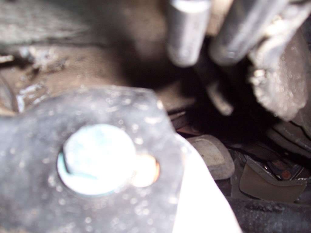

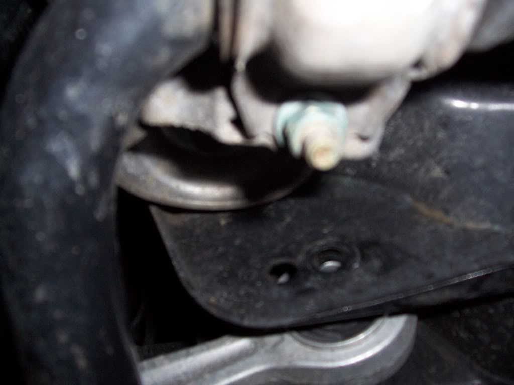

Just so y'all know if you replace your control arms - my B5 has 2 sets of holes for the front lower control arms. Stock position was inner hole. I put them back there with the coilovers and new control arms installed. Don't put it in the wrong hole guys.
Front Lower Rear Control Arm
Front Lower Front Control Arm
