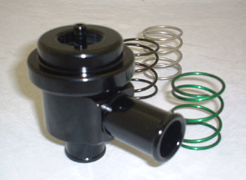

Cant find that on ebay. is the forge any good?? Im only looking on ebay coz over here in New Zealand the dealer said it will take a month to come from germany and will cost me 174+gst. Which is a buit high. How about this one from ebay. Any good??

looks just like a forge but i think its a knock off. let me think a bit more about what could be wrong because like a said i havent herd of stock dvs fluttering in audis

Its a knock off , we haven't produced that valve in well over a year. The new 007s have shorter ports, a different design to the cap, and a Forge logo. Also the spring colours are wrong...
Unfortunately we don't have any dealers in New Zealand.
