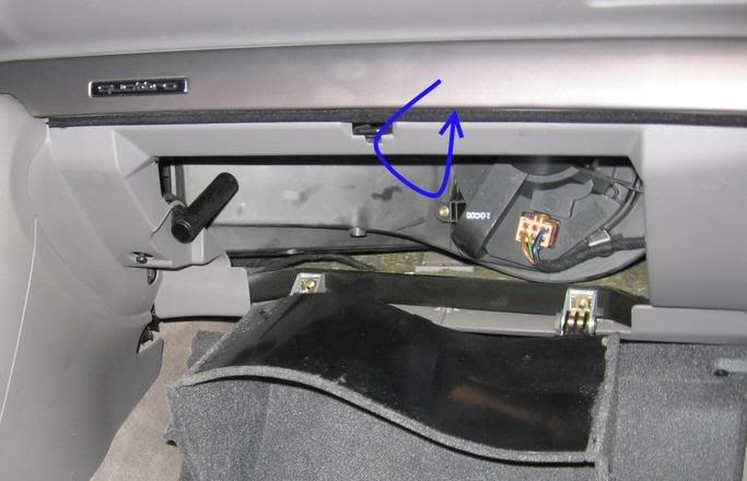

My cruise control has been dead since I bought my car and i was looking through some write-ups on audidiy.com and i found a good write up to test the module but it doesnt have any pics. well i went out side dropped the glove box down and tried finding it but i had no luck. Can anyone point out where its at on this pic?

Old Jan 15, 2008 | 11:20 PM
djmika's Avatar
Joined: Dec 2007
Posts: 27
Default RE: Looking for the cruise control module
Yeah, I have the same car and I was unable to find the CC module myself. I wonder if they did something different in the 2K Manual cars.
It's mounted over the glove box, so you can't see it from that perspective...to see it, you have to get your head down there and look straight up. It's probably at about the same level as the aluminum trim and maybe slightly left of being centered over the glove box. Mine had a brown connector.
what sineo said...

Old Jan 15, 2008 | 11:51 PM
acollicott's Avatar
Joined: Jun 2007
Posts: 1,077
From: Iowa - Land of the Corn
Alright now that I know exactly where to look maybeI can find it.The write up said that if you knew where you are supposed to look you shouldnt ave take off th glove box. we'll see about that tommorow
ORIGINAL: acollicott
Definitely not. Removing it wouldn't make it easier to get at the module anyway. Once you've crawled down there and located it and the 8mm nut, I suggest sitting in the passenger seat and tackling it blind. For me, that was much easier than trying to kneel next to the car and twist into a pretzel trying to get a view of the module AND get my hands and ratchet in there.

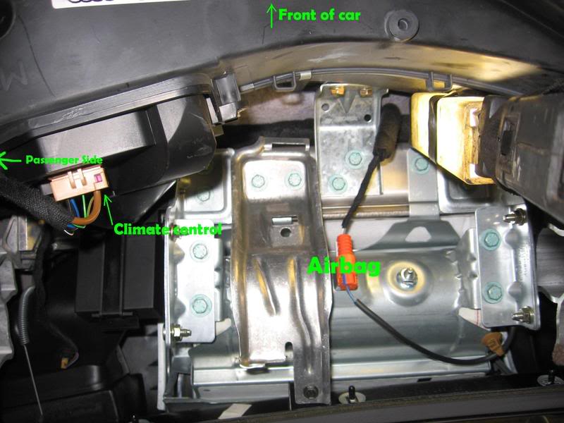

Well I tried finding it again took off the glove box got my dirty *** bent down in there and still couldnt find it. Ive got a couple pms from other people having the same troubles locating it so Ithink that the 2000 or a 5-speed must be different than the others.
I took an under dash pic
i have/had the same problem on my 01....... but if i remember correctly...... someone told me that the 01's might have been on some sensors and that there is no modual....... but search won't go that far back, so i can't find it

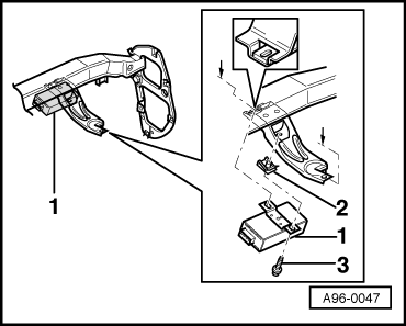

Well acollicott, according to your VIN number it should still be under the dash behind the glove box. This is from elsa web, so if the module isn't there then someone took it out.
Cruise Control System Control Module, Removing and Installing
Follow the sequence of operations below:
Remove glove box.
→Body Interior;Rep. Gr.68;Storage Compartments, Covers and Trim
Â
Detach control module -1- by removing Phillips-head screw -3- from clip nut -2-.
Tightening torque: 3 Nm (27 in. lb)
Withdraw control module from mounting bracket and disconnect harness connector.
