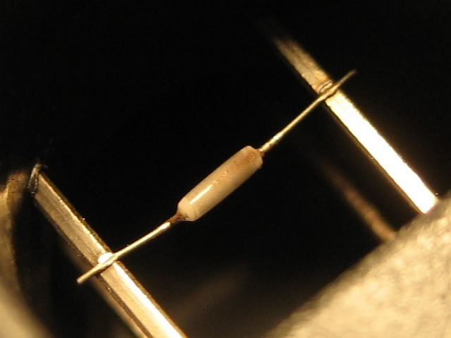

I cleaned the MAF already. DPO had a K&N air filter on there for the last few months, the filter was replaced with paper stock, and then I cleaned the MAF with contact cleaner, an I think i need to replace the MAF no matter what. If I had a big vaccum leak wouldn't I be running lean since there would be more un-metered air getting in?
Any reason to avoid the remanufacted MAF from ECS tuning?
Macro shot of a MAF for those entertained by such things...
after cleaning with contact cleaner
after cleaning with rubbing alcohol + qtip
edit: fixed image links
