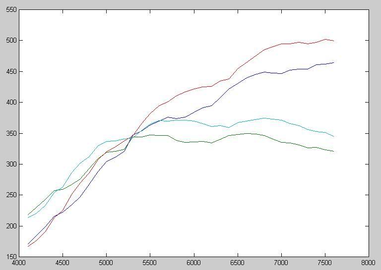

Logs will ALWAYS spool faster than a tube manifold. WHY, becuase there is more heat and very little distance for the exhaust to travel.
Maybe this will help
GT30R
Compressor 76.2mm, 56 Trim .60 ar
Turbine 60mm, 84 Trim, .82 a/r
AER Stadalone Management (England)
Both Pulls @ 23.5 psi
Superflow Engine Dyno
Full Race
hp - red
tq - teal
ATP
hp - blue
tq - green
