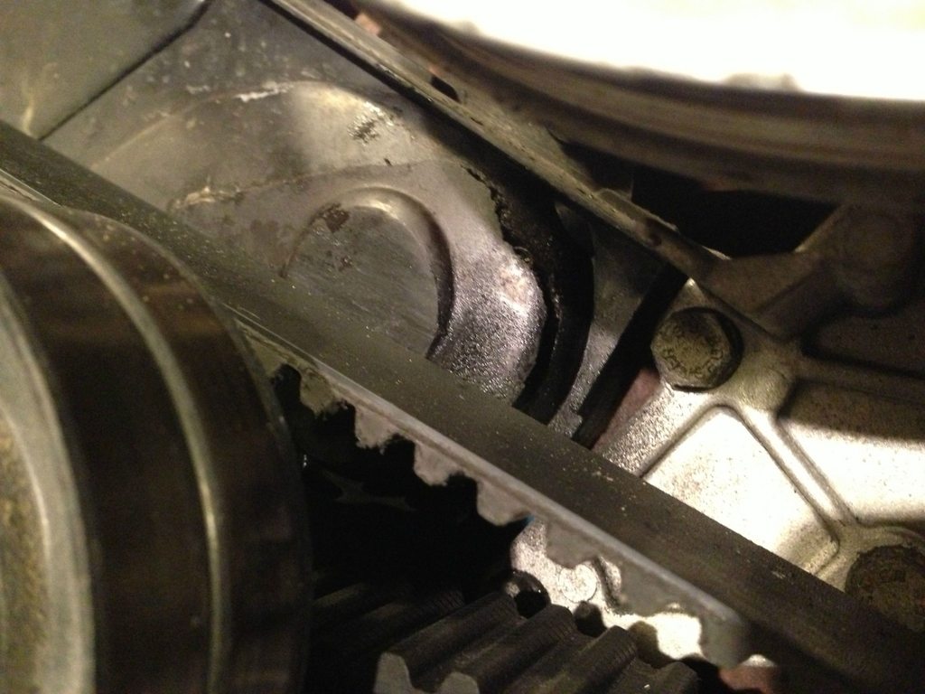

bunjamins Aug 20, 2013 11:16 PM
2 Attachment(s)
thanks nebuchadnezzar, Unfortunately I think I found the problem, and I don't think it's that simple. There is a large plastic part on the front of the engine, behind the timing belt on the passenger side that is cracked. This is where the coolant is exiting the engine, I assume this happened from too much water in the coolant over a Utah winter. Can anyone tell me what this part is and if I can replace it myself assuming I had the knowhow to get to here? Also does this kind of damage on this part point to possible other damage internally?Attachment 66323
Attachment 66324
bunjamins Aug 20, 2013 11:49 PM
OK, found the part number on the cracked bit, 078121121k. It googles as the thermostat housing cover, so my questions are all answered. Hopefully my local import joint has one on hand.
Nebuchadnezzar Aug 21, 2013 12:29 AM
Yup. Thermostat housing. You might as well put a new thermostat in there, as well as the thermostat o -ring as well since it'll be off.
Although I've never tried it, I'm willing to bet you can probably wiggle the housing out from behind the timing belt without taking it off, thus taking care of any headaches associated with a timing belt job.
Though, that brings me to the next question: Have you had the timing belt done on this engine before? If not, now would obviously be a good time to do it since you've made it this far already. If it was done recently, then I would give it a go and see if it's possible to wiggle the thermostat housing out from behind the timing belt without removing it.
