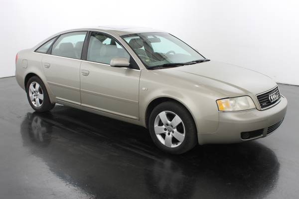

thanks for the advice I did pass on that one. and picked up another 2002 A6 3.0 has a few miles on it 180k body is in excellent condition, interior good condition tires good new battery and brakes drives like new runs good but has check engine light on and ABS light.
I tried to read with OBDII and get err. did some reading and tried unplugging ABS controller still cannot read. I am sure there is power at plug when i first plug in scanner it powers up and says OBDII then i hit link and get the err. I figure for what I paid i can handle a few headaches figuring this out.
