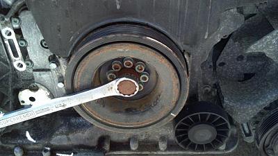

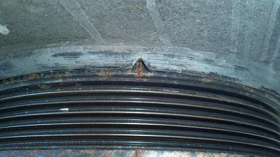

1. Initially, I thought the timing mark was the white line on the harmonic balancer but when I placed the cover (with timing mark) it became apparent the real mark is the line cut into the balancer. Is that correct?

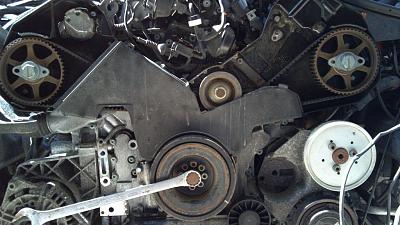

2. I expected to see the camshaft "wings" perfectly in-line from one another to aid in connecting the camshaft lock tool but I see the passenger side is a little off. It would appear the timing is off at least a tooth. Is that a correct assumption?
3. The belt is extremely loose at the top, certainly not enough tension to drive the water pump (which is the primary reason for beginning this work), at it appears the hydraulic tensioner shaft is not extended at all (with pin out it is fully enclosed in the housing). Is that a symptom of tensioner failure?
