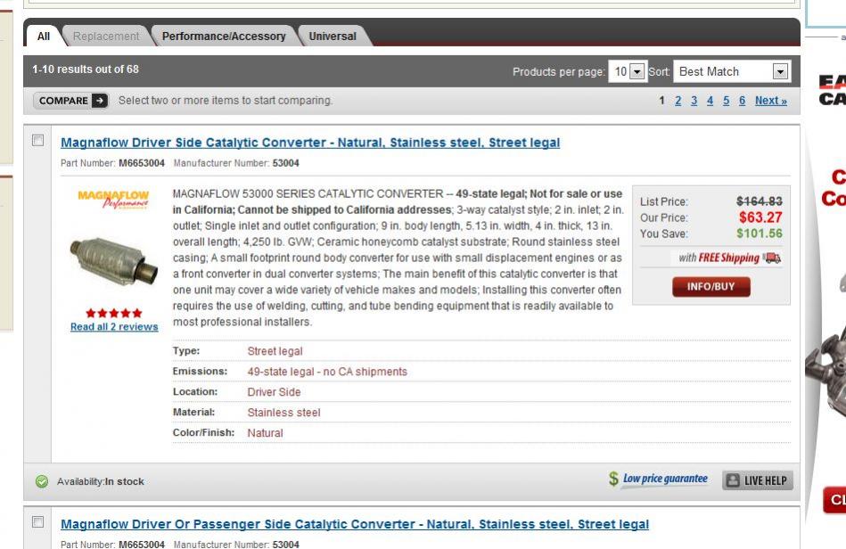

Your car is newer, so I don't know if the same model will work, but I put Magnaflow cats on my '99 and they worked fine. The downside is that you'll need a reciprocating saw with some good blades to cut the old ones off and a welder to put the new ones in. The upside is that they only cost about sixty bucks each. They hang down about an inch lower than the stock ones, but unless your car is really lowered, I don't think you would have any trouble.

I second the vote for a MagnaFlow cat. Any decent muffler shop can do this for you. If they say they can't, well, now you know they aren't a decent muffler shop!
AS to which side is which, just do both sides and be happy!

If you are in California, most shops will not install 49 state converters. Unfortunately OEM is the only available/approved converters for our cars in CA that I know of. If someone has any info on inexpensive 50 state legal converters, please chime in.
