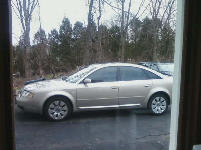

All I have right now is a crappy cell phone pic of the car. Need to get a new camera.

Very nice! I'm sure you'll enjoy it.

car is gorgeous! I recomend (as my mechanic did) 15w50 as it is a performance oil. Of course you need the weather to stay on the warmer side to run it. I use it all year long in new england and never had a problem. Mobil 1 has always gotten me 200k out of my cars. I have a 2.7t but was told the 4.2 had a chain not a belt. Dont get taken at the auto shop!!!! here is a thread from this forum about the 4.2 having a chain or a belt. https://www.audiforums.com/forum/sho...d.php?t=128855 good luck!!!!!!!
