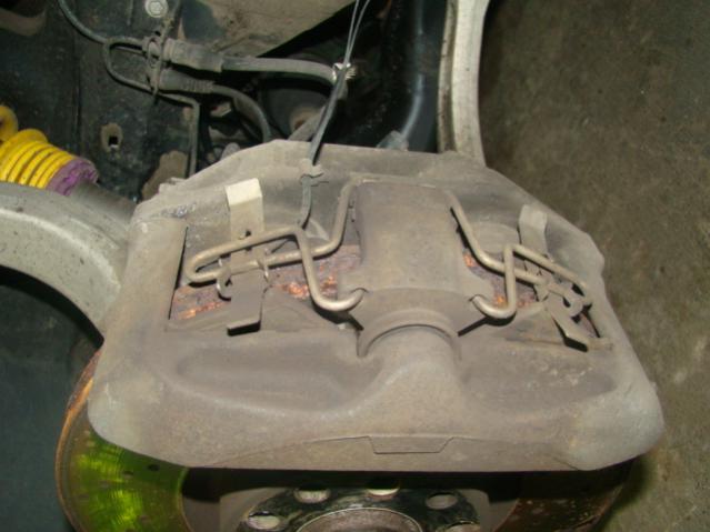

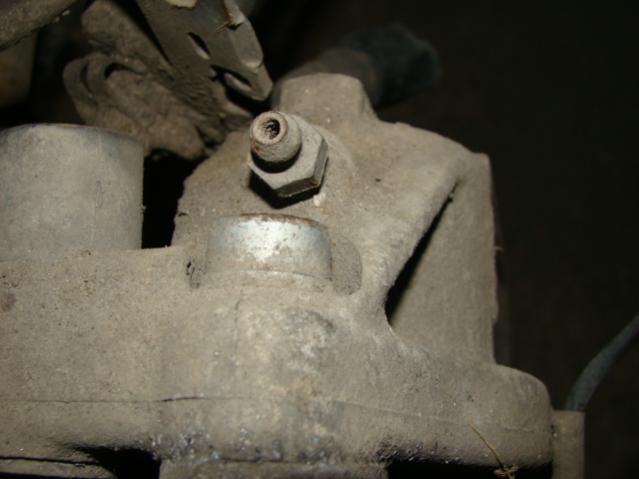

I am starting on the Front Brakes now- I have the 4 pads per caliper Brake system on the front. It is the larger one and most of what I have read doesn't address this system.
1) There is a little "nipple" plus bolt (see pictures) blocking what looks to be the first set of hex bolts that I need to remove- Is that the bleeder bolt- and is it normal to need to remove that to access the bolt?
2) Are those hex bolts the correct ones to remove first...
Clearly I am reluctant to start taking off the bleeder as I have heard horror stories of breaking it and such..
Anyone with knowledge (or some pointers..) would be greatly appreciated..

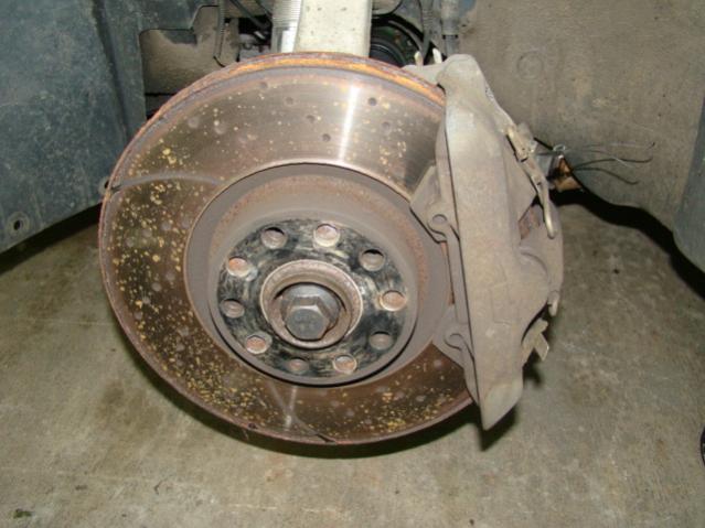

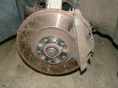

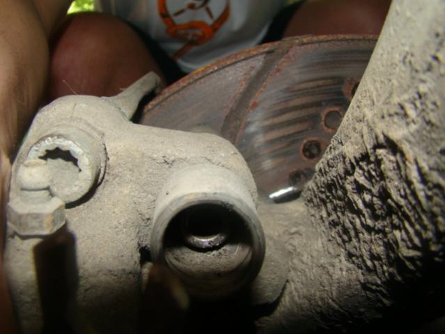

--first two pictures are for a visual- of the braking system- 3rd is top down showing the nipple bolt in front of the hex bolt. 4th is from inside the well- back at me- showing the bolt blocking... and 5th is the lower bolt-not blocked. I can't exactly tell what the bolt or slider is next to the hex- but it did have a cover over it...

That's a lot of questions, here: http://dl.dropbox.com/u/57832/Audi/A...2%20Brakes.pdf (i have no idea why the images got inverted).

just remove the larger 18mm bolts to remove the caliper.

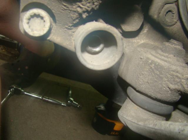

I am trying to replace the rotors as well as the pads- so the link for the pads helped- now I need to be sure about removing the rotors-
the 18mm bolt... I saw two large bolts on the back but they are larger than 18mm... are those the ones you are talking about... Just below to the left- of the slider...?

those two are 21mm if I remember correctly. Pull those (They can be seriously stuck on there) and the caliper comes right off.
