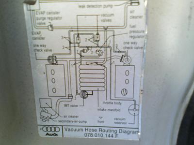

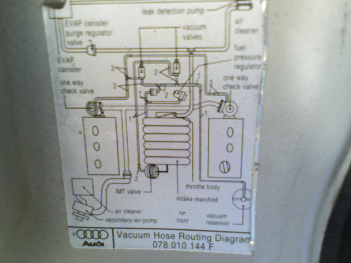

Can post a picture of 2.8L Vac Lines, I'm changing them out, I've changed the PCV Y thing but I don't know where all the vac lines are. Please PM me and we can arrange anything or just post here, I'm good on my word!
Throwing a code because I have a really bad leak car idles rough!
Thanks!

ehh thats not my engine, I found pictures, listen, send me your paypal and i'll throw you something incase you are correct.

actually you might be correct.
edit. oh god im spamming this ****, if somebody can tell me which is the correct one, i will send him the dough!

They are the same. One just has like a different view.

there is a vac line diagram stuck under your hood on the drivers side

Which ones am I changing?
Thanks OC_Audi

On my A4 with the same motor I found the breather hose hanging off the intake elbow at the back of the throttle body. This made idle rough and occasionally would stall too. If you are trying to find a smaller vacuum leak, spray carb cleaner around the hoses and listen for the idle to go up slightly. Be careful though! You don't want to set anything on fire!
