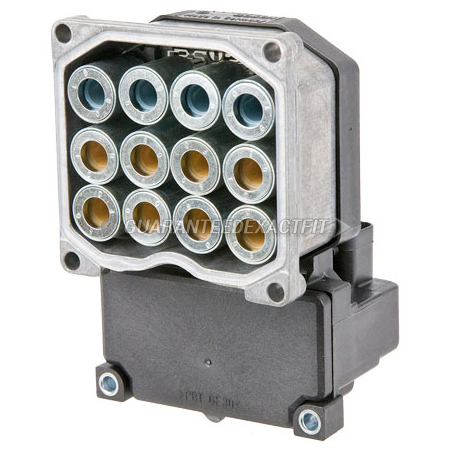

Having ABS issues. My service manual says that the ABS controll module on my year model is located on the passenger footboard. All the videos I find about changing it show the work all being done under the hood. The manual says that after 2001 the control module and the pump are all one unit... anyone have a 2000 A6 2.8l that has done this that could verify for me the location? I would rather not take out the carpet etc. on the passenger side to find nothing there.

Have you looked for it under the hood?

yes. There is an ABS component under the hood and I think the control module is part of that but my Bentley service manual says its not and I dont know for sure what the control module should look like nor what the other component would look like without the control module attached. I know that the videos I have seen of people changing the control module does look like whats under my hood. That is why I asked here...to see if someone could confirm for me.

It should look like this, under the hood, attached to the metal box with a bunch of lines coming out of it.

yup thats under the hood. So, not that you would know for sure but why the heck would the service manual say the ABS is in the passenger floor board for my year model when its clearly not? I have also noticed that the fuse panel is not correct as labeled on the cover nor as indicated by the service manual. How the heck is someone supposed to find electrical problems if the damn literature is wrong??
