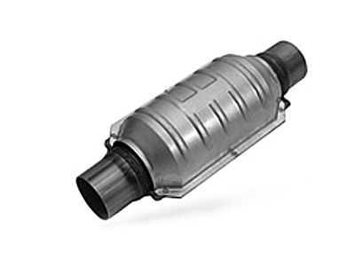

My wife's A6 has the 2.8, so I don't know how different the exhaust system is from a 2.7T, but on hers, using universal cats was by far the least expensive fix, and it wasn't all that difficult. I disconnected the coupling behind the cat on each side, and once you cut the cats off, you can pull what's left of the down pipe down at the flex coupling enough to weld the new cat on without even taking the pipe loose from the manifold. The universal cats I got are round, so you lose about an inch of ground clearance, but for $60 each, its a worthwhile tradeoff.

If you dont mind me asking, did your car have a CEL or codes telling you you had bad cats? And if so, did the universal cats make the CEL go away?
Also where did you get the universals?
I think the model number for the ones I bought is 642-53004, and if I remember right, I got them from Jeg's.
The CEL was on before I replaced the cats, but I don't have a scanner, so I don't know if anything changed afterwards. One of these days I'll have to look into the whole VAG-COM thing since I think I'm going to have this car for a while.

The 2.8L has a LOT more wiggle room around the downpipe area than the 2.7T, you won't be able to do that procedure without pulling the entire downpipe.
To the OP, if you are unsure of where the cats are, look for the O2 sensors. If there isn't an O2 sensor after what you think is the cat, then its not a cat.
