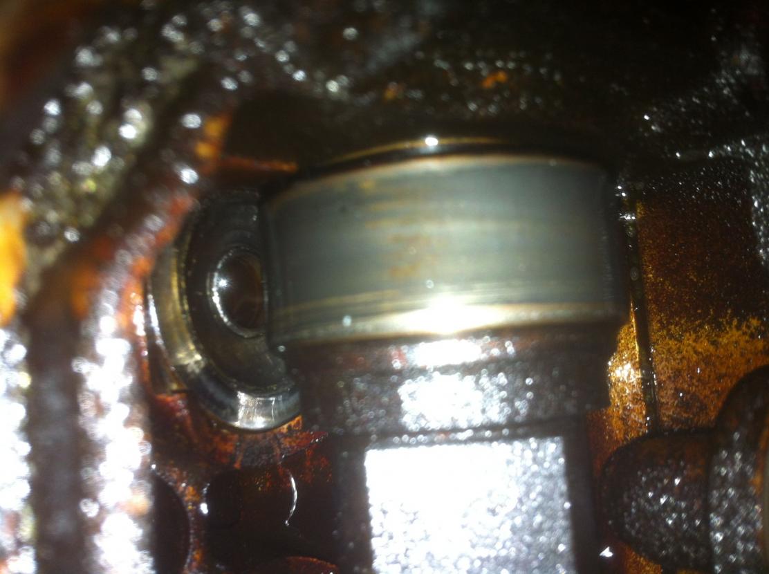

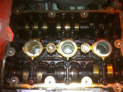

Valve Covers Off
Ok, I pulled the valve cover off today and this is what I found.
The two lifters in the middle are worn but the left one of the two is worn completely through as you can see in the pictures.
The cam lobes are pointed down at the moment but they don't seem to be worn any more than the other lobes.

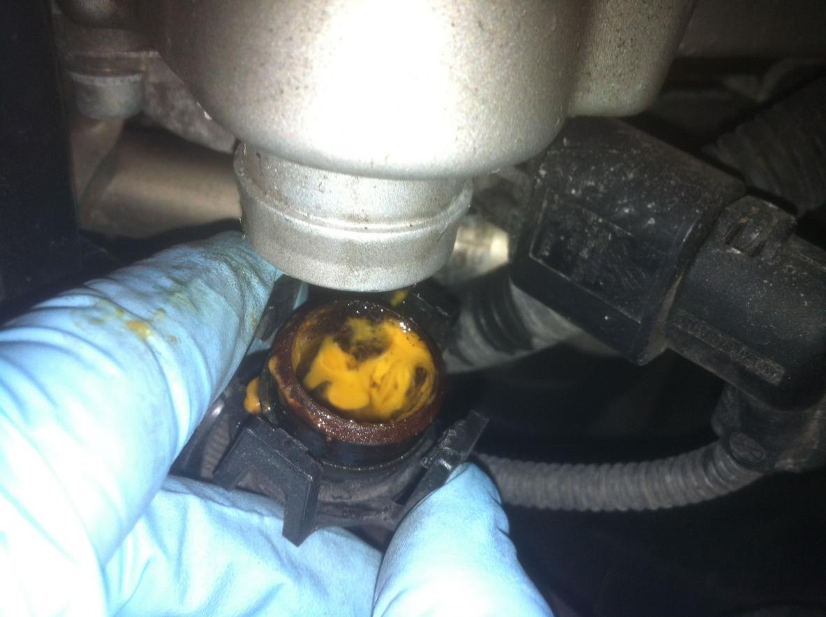

I also noticed this yellow gunk in the crankcase breather hose.
I don't know for sure how to fix this problem so any info is appreciated.

There is an TSB from audi on the problem with premature lobe and lifter wear.
Don't think it really matters at this point though.
That yellow crap is new to me but the crankcase line is a crap collector
Mine was all caked up. disgusting.
Your best option is to buy a remanufactured head, Used might cause you more problems but...
You would need to replace too much on that head to be worth rebuilding I'm sure the metal particles have done a number on the rest of that head.
Your going to need a head

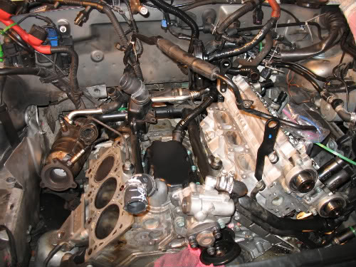

I really like the car. It is in great condition. Everything works great except for the lifter noise. I am not inseperable from it though because I can always get another one just like it. The biggest problem is that I have a loan out for the car.
I have the car in service position and everything taken off down to both valve covers. I don't have the timing belt off yet because I am waiting on the timing tools which I have already ordered.
I need to get my car fixed so that I can drive it for now. My question is can I just replace the worn lifters for now and drive it easy for a little while. Then I can tear the car down and replace the head when I save up a little more money.
I know its not the ideal fix but I need to be able to drive my car. It would be a lot of work but I have enjoyed it so far and the best part is... the labor is free because I am doing it.
I believe I can follow the bentley to remove the timing belt and everything but what about the cam and lifters? I don't know how to remove them or the correct way to prepare the lifters. I have read about people doing it different ways but Im not sure how to on the 3.0. Should I soak the lifters in oil first, then put them in and let the car sit overnight before starting? I also saw that some say to let the car run for 30 minutes after initial start also. I have never done this before so I need a little help.
Thanks
Thanks

Changing the lifter means pulling the cam. A fairly involved task but doable if you are at all persistent and used to working with tools.
The thing you mention about the 30 minutes is actually to let the engine sit for 30 minutes after tightening the cam grid down to let the hydraulic lifters settle down. If you start it right up, the valves could go through the pistons.
What I am getting at here is that if I needed to drive the car anytime soon, I would have a mechanic do the work. I am very experienced and probably would only tackle this one if the car was a spare.

I want to do the work myself. I have the hardback bentley service manual but after reading through a few posts I believe I need the bentley repair manual cd to have help with the cams. Is this correct?
Does anyone know if the bentley cd will tell me how to replace the cam and lifters?
I want to take out the cam and post some pictures to get some more feedback so that I know what I can get by with.
