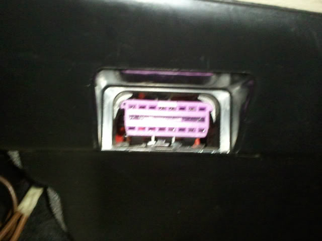

TCM Audi 2006 Turbo 4B0 927 156 FE
I had a rear roof leak. There was a crack in the water lines... It filled the passenger side only with water. Driver side was clean and dry. I ended up removing the driver and passenger seats and pulled the carpet off to dry. My TCM module was completely destroyed, I ended up buying a 4B0 927 156 FE replacement module on ebay.. I cleaned the the plug completely..
