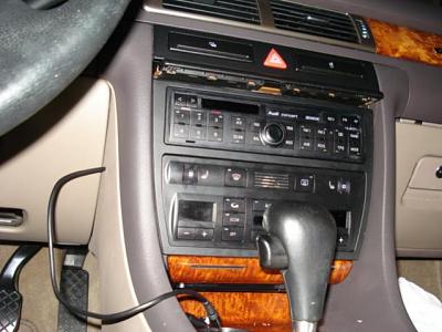

http://www.audiworld.com/tech/elec142.shtml
Search for this phrase "This is the harness that connects the CD changer to the head unit. The red and white wires are the audio lines that have been cut and stripped. ".
Then look at the picture, that is where you wan to install your AUX cable (headphone cable)
Don't do anything else unless you feel like it. It is really simple, and I just drilled a tiny hole where my right knee would be
Ignore everything else in this thread.
