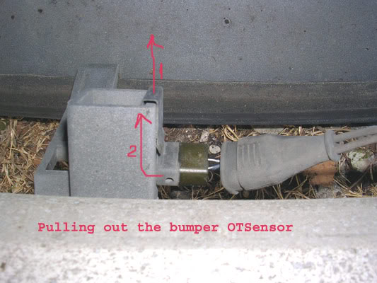

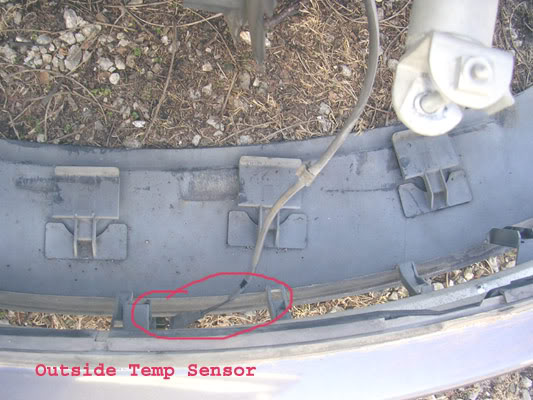

Hello All,
I have been experiencing trouble with my Exterior Temp, which resulted in the Climate Control trying to warm up the car while it was about 15 °C outside (about 60 F).
My Exterior Temp in the dash was displaying -9 °C (about 15 F), so the Climate Control was trying to warm up the interior... Had to open windows and shut off A/C... Was getting a little too warm in there !
Questions:
From the previous posts in this thread, I deduct that I have a faulty Exterior Temp Sensor. Where is that Temp Sensor located on my 2001 A4 2.8 quattro?
If I have to change that sensor, is it available in some Internet stores ?
If it is not the Sensor, can this trouble indicate problems with the A/C system or other thermostat problems ?
Thanks !
Frank
Questions:
Thanks !
Frank
the Exterior Temp Sensor is located in the front bumper, lodged in right behind the lower grill. The location is somewhat in the middle area of the bumper. I'm pretty sure if you take the belly pan off and get under the bumper, you should be able to locate the sensor's wire and follow it.
on a 01 It looks a little different then Chefro's though, it's black and is just hanging out in front of the radiator in a plastic clip. Mine is bad and I get a fault code for it. But I haven't tested it yet. It could be a crushed wire the way they run along the bumper cover like that.
