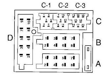

The Dension replaced the in trunk CD changer - mine is still in the trunk plugged into the 13pin connector (without the 6 disc magazine installed) it is dead once the connector is removed from the back of the radio so remove your CDs first! I forgot and had to connect it back up to get my CDs out
MDRSK - you do not have a trunk changer so just go ahead and fit the Dension per the install guide. You will have the large 20pin connector in your radio even though you do not have a CD changer in the trunk. Shown below as connector block C - mine was solid black, some are split three color plugs C1 C2 C3.
You didn't say if you wanted it for ipod or USB ..... for playback from USB you just need a regular memory stick or hard drive formatted to fat16 or fat 32
If you want to use your ipod you will need the Dension IP05DC9 iPod Cable and if you want to use it as an AUX in you will need Dension CABL-AUX Auxiliary Cable.
NOTE - you can only plug one of these in a at time because they use the same socket ....... for this reason I put the Dension in the glove box - this allows me to plug the memory stick in without an extension cable or easiliy
plug in either cable for ipod or AUX.
