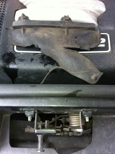

We had a customer send us a photo of this rubber latch cover. Part number 4B3-806-663 noting to us that if it hits the fan blades and/or drops down towards the fan motor this could cause the motor to fail prematurely. We wanted to share this with the A6 owners here and prevent this from happening on your vehicles. Good news is that cover is under 8.00 if needed. Any questions please ask. Thank you, Jeff.
