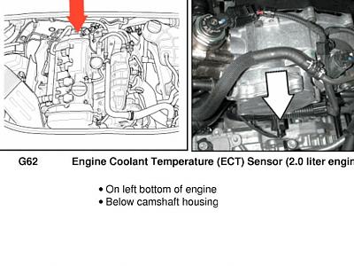

Hi all, looking for some help. I have a 2006 fsi 2 litre turbo.
I have a non working temperature sensor and need to replace it . I do not know where to locate it and the ease of replacing it.
Is it handy enough to replace?
Couple of images to help me locate it, many thanks

It's on the rear of the cylinder head, under the cam adjuster housing and vacuum pump. Kind of a PITA to get at.
If you haven't already, make sure you get a new o-ring and plastic retaining clip with the sensor or you will HATE yourself later. Don't ask how I know this...............
