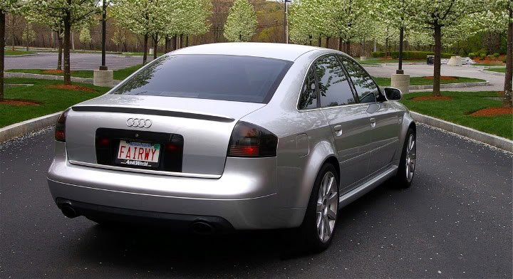

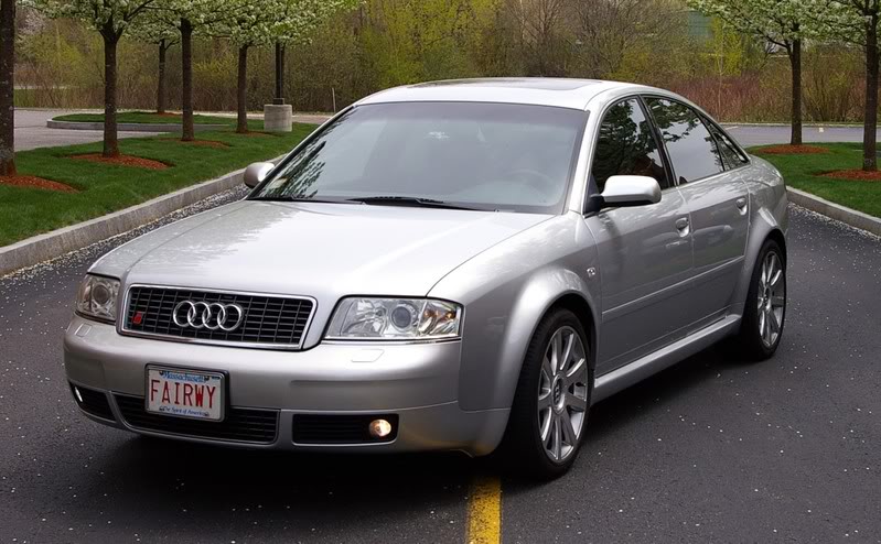

oh, and pics of my car with the RS6 sides and the S6 grilles on the stock bumper...
And from the back, RS6 spoiler and stock A6 bumper with RS6 exhaust...
