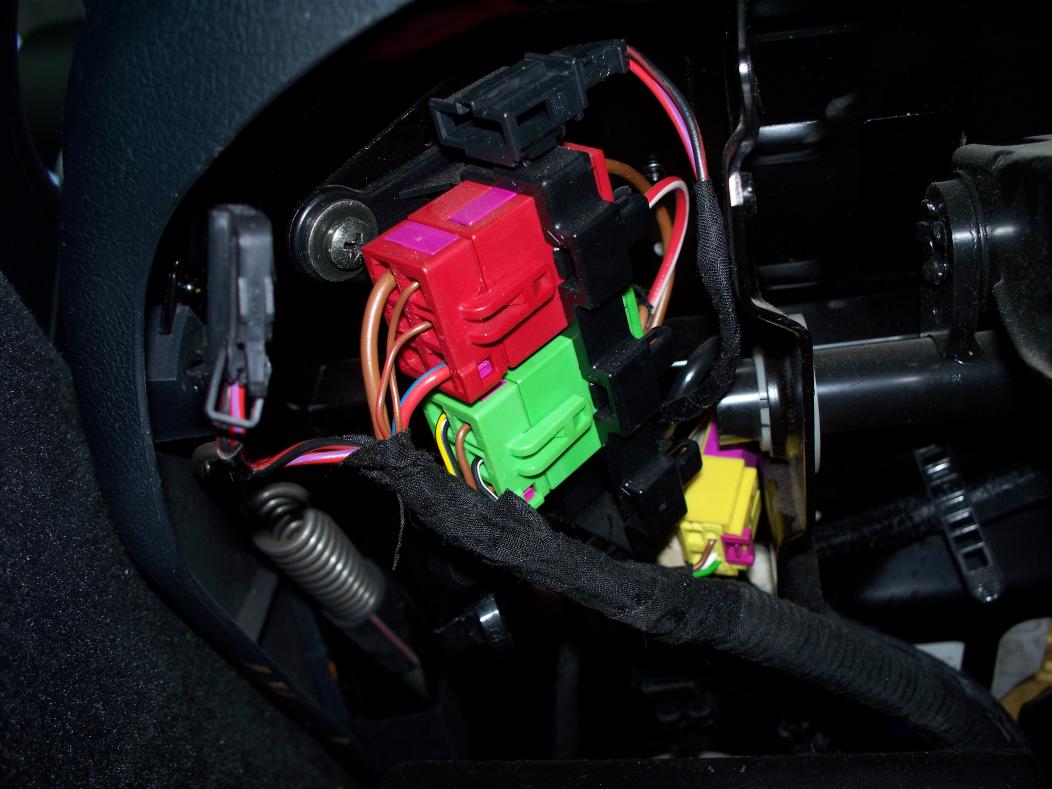

common problem, well becoming common at least.
The drivers side rear passenger foot well light is shorting out telling the cars ecu that the rear door has opened and turns the dome lights on. The light you are looking for is under the drivers seat. Open the rear drivers door and you will see it lighting up the floor down there.
To solve this temp. disconnect that light from the circuit. I can't remember exactly, but on the front of the driver seat next to the center console there are a bunch of wire harness connectors. Unplug the one leading back the the light. You might be able to just remove the bulb, I never tried that. See pic and look for the black connector on top the the red one.

I tried to disconnect the black connector from the picture. But I am not able to approach it as it is attached to the seat from the bottom. Any technical solution for this - should I detach the whole seat in order to approach this little connector? If yes, how?
And I didn't understood what is the solution for this problem - I guess when I disconnect connector it will stop flashing lights and sending weird massages to the control unit. But at the same time some of the functionalities will disappear (which?). What should be the long term solution to have all functionalities operative?

Finally, I managed to disconnect connector and seems ok now.
