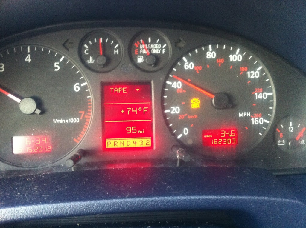

To start, I need to replace my alternator, I got it from autozone and I think it's defected since its producing too much power and blowing few fuses (window and interior lights for example)
Is there a how to? There aren't too many Audi mechanics around
Also I think this is alternator related, but the cars acts funny, it seems like its stuck in second gear when I slow down and it doesn't shift...here's what I see, I have to shut the car off and start again to restart this

First mistake you made was buying it from Autozone(4yrs max before you'll have to replace). It looks like your in limp mode. If you access to VCDS/VAG COM scan your car and check for faults. You maybe have a defected alternator that's setting off ECM and TCM.

I don't like the looks of your last pictures. The volt meter shows almost 16v (red) which could indicate too much power going to it. Simple test though: Get a volt meter, turn on the car and check the Voltage of your battery ... now turn on the headlights (or high beams) and measure again, finally rev the engine to 3k and see if the headlights go brighter while you do that (also measure voltage). If the lights go very bright while revving the engine you do have an alternator that gives too much. The volt meter will at least give you some numbers to work with to prove to yourself it is bad.
