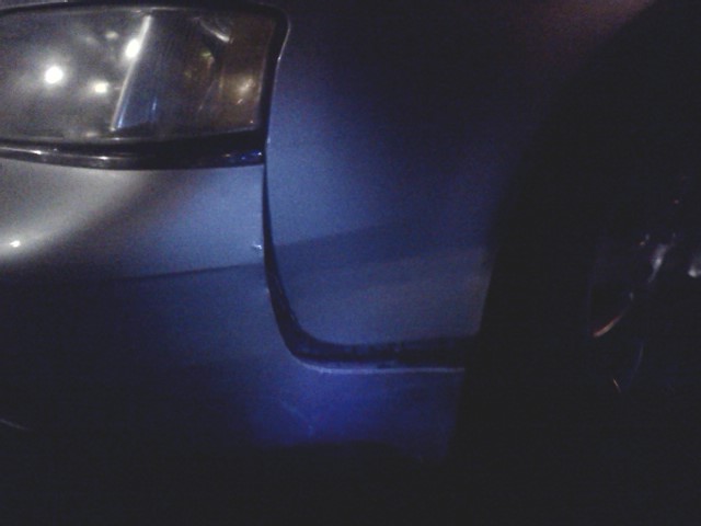

So I was at the bank paying off my credit card, and when I left I hit a curb with my bumper (Not even fast). So I was stuck, backed up and it kind ripped my bumper off. Now the clips are broken under the driver side lights and its disconnected from the fender leaving a huge ugly gap. Any tips on what to do, how to fix it, etc.? Thanks

well placed zip ties. they're holding up my lower front valence now (i went too far over a curb and got stuck on the way out)

Get new clips, jack car up, take tires and wheel wells off, take of front bumper, replace clips, fog lights and decorative covers if broken, reverse. I did the same thing last year and ended up rehanging my bumper. Took about 2 hours.
