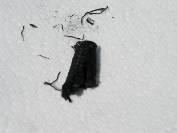

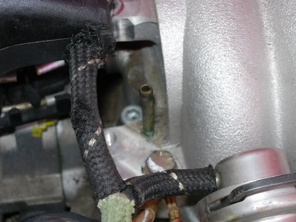

Some of my hoses were in pretty bad shape.
I was in a little bit of a hurry...sorry for the bad pics lol
In the middle of the top black hose it was definitely cracked in half.

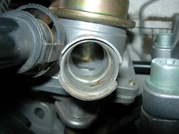

EGR valve/combi valve

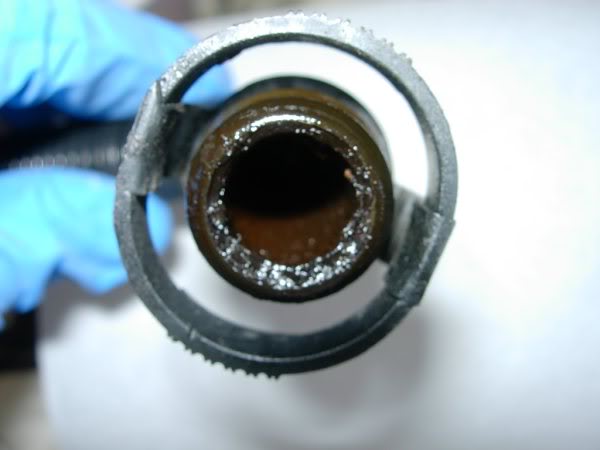

valve cover recirculating hose? I cleaned it out with carb cleaner.
