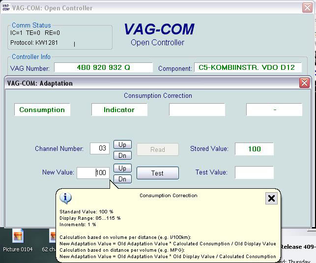

1 question - What is the best value here:

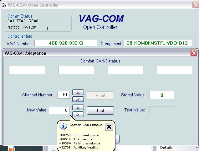

6 question - Can you explain me about this?

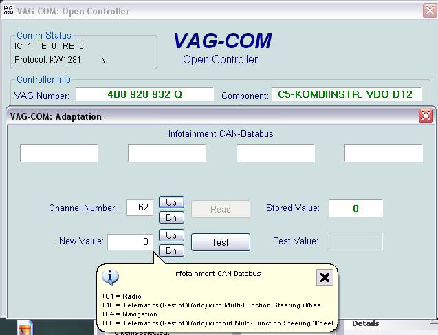

7 question - What can I do with this?

All of your questions regarding "what value is best here" can be answered easily: the current value is the 'best unless you're having problems and it needs to be calibrated differently this goes for #1, 3, & 8. I really want to give you a word of caution before playing with most of these - you can screw up things if you're not too careful, I guess it's good you're asking, however.
