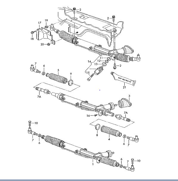

Jeff-AudiUSAParts 05-31-2012 12:22 PM
1 Attachment(s)
Here is a picture of the rack to your car. I just thought you will have to be careful on the direction you turn the inner tie rods or you will throw off your perfect alignment. This picture would be looking at the rack as installed from the front of the car, looking at if from the left front viewpoint. Since 7a is the inner tie rod and they are the same p/n's L to R we can assume they are both right hand threaded. So if you want to move your steering wheel 10 degrees to the right (clockwise) you will need to rotate the pass side inner tie rod lets say one turn so it spins IN to the outer tie rod. Then rotate the drivers inner rod one turn so it spins OUT of the drivers outer tie rod. This will maintain correct alignment but will move the inside of the steering rack just a little bit, which in turns rotates the steering wheel hopefully to perfect center.
I wanted to note this so you didn't spin the inner tie rods both into the outer tie rods, you'd be screwing up the toe in if that was done. And I wanted to check to make sure on the tie rods wasn't left hand threaded.
Attachment 29249
