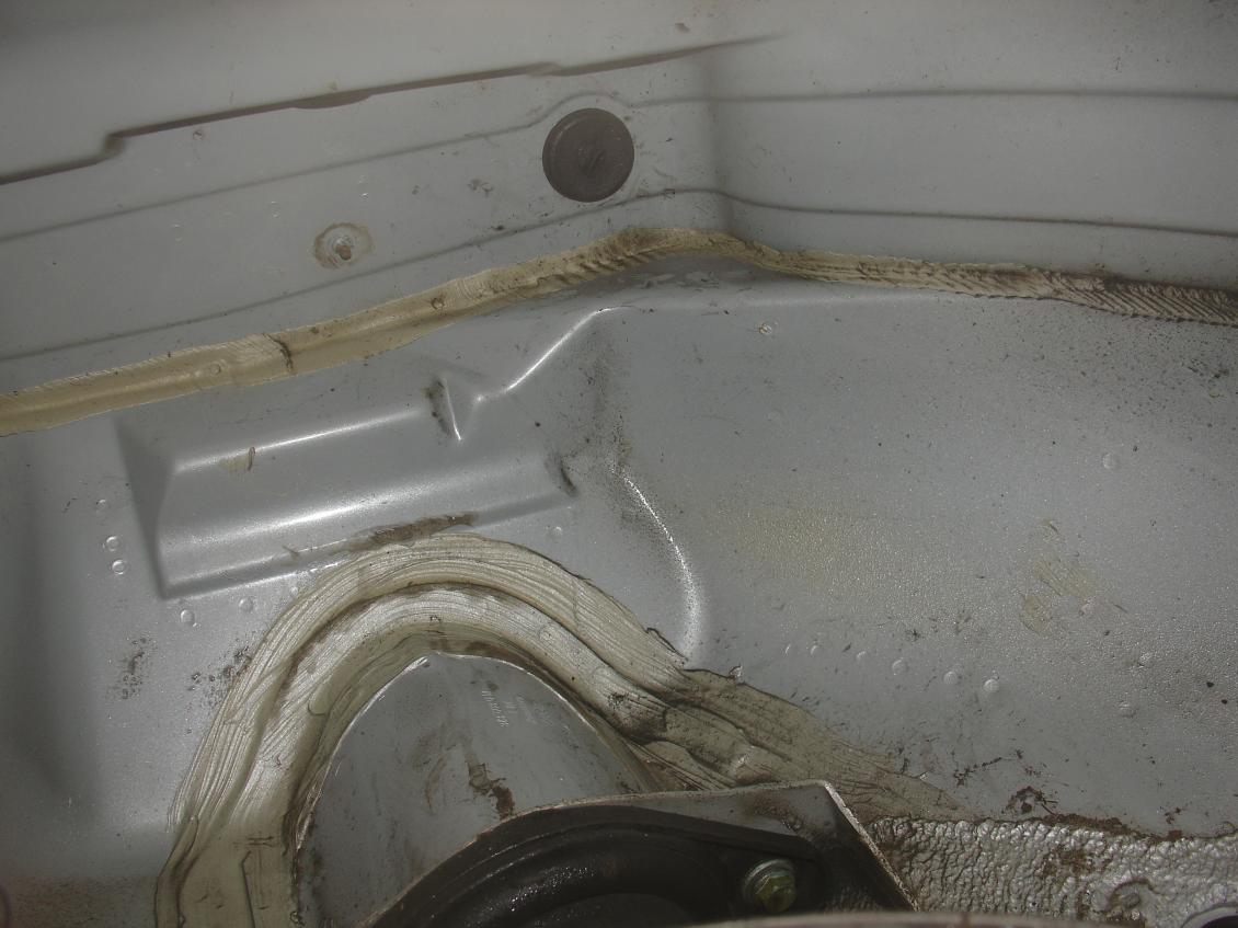

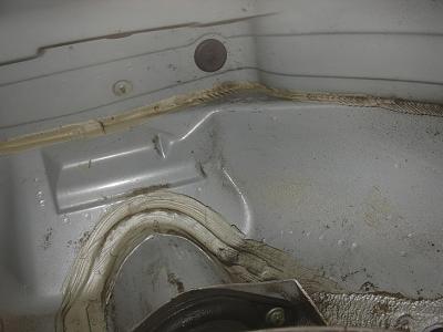

Great pic - it will really help people that come across the thread, searching for solutions.
I personally had only the rain tray problem. My drains were clear, although at the time I went through the whole hassle of taking the whole headliner off.
It looks like the drains on a C4 are much easier to locate and access.
Thanks again for the addition pic.
