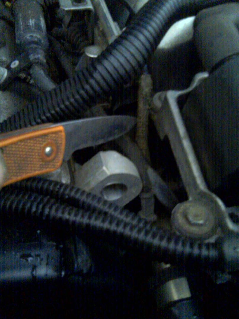

Ok. update. I just got done replacing all the vacuum hoses (except the hose right between the pump on the front of the engine to the thin plastic side hose[see pic]). My CEL is still on! any suggestions? any sensors that might be out? im lost
