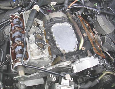

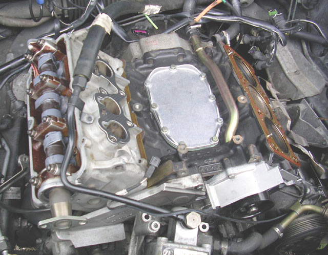

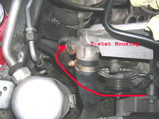

On the 95 2.8 the T-stat is located on the front (Bank 1 side).
I read that it can be replaced without taking the timing belt off, but unless I do it and know exactly how's it done, I wouldn't put my seal of "knowledge" (LOL) on it.

i did the stat on that motor and it is right behind the timing belt. It can be done without removing the belt but i did lossen mine. there is an aluminum housing that a hose ataches to that it sits behind. \huge pain in the *** but can be done.
