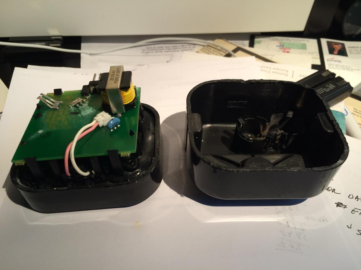

My alarm horn stopped working. Went to the dealer and a new cost $330 So I ordered one off of Ebay, got installed it same thing not working. So I opened up my horn and found that that batteries were bad leaking all over the place. Cleaned everything up tried to find some new batteries no luck. Found a site (Audi A4/B6 Alarm Siren - Replace NiMH Batteries | Audi-Sport.net) it's from England. It has a way to modify the battery pack. I tried one thing to make sure the horn and circuit board were still good. I plugged the horn back in without any batteries and it works. so some how the bad batteries are screwing thing up.

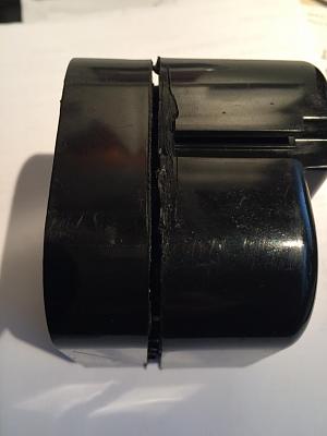

Originally Posted by schiu
How did you manage to open the alarm horn. Is the unit sealed as I don't see any bolts
There is a seam where the 2 halves are glued together. I took a chisel and hammer and careful separated the halves. Inside you will find the batteries which are likely dead and leaking
