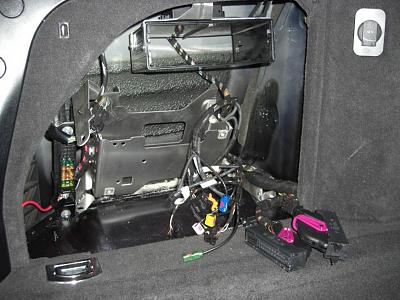

Take a picture of whsts missing so we can have an idea what all you need. I would also check with Shokan and Car-parts.com great source for used parts. check the NY craigslist i bought some stuff off of there not too long ago and there is guy with an S8 parting out

And absolutely - most of us can tell what's missing from a picture.

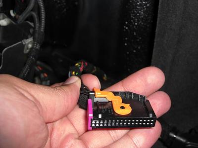

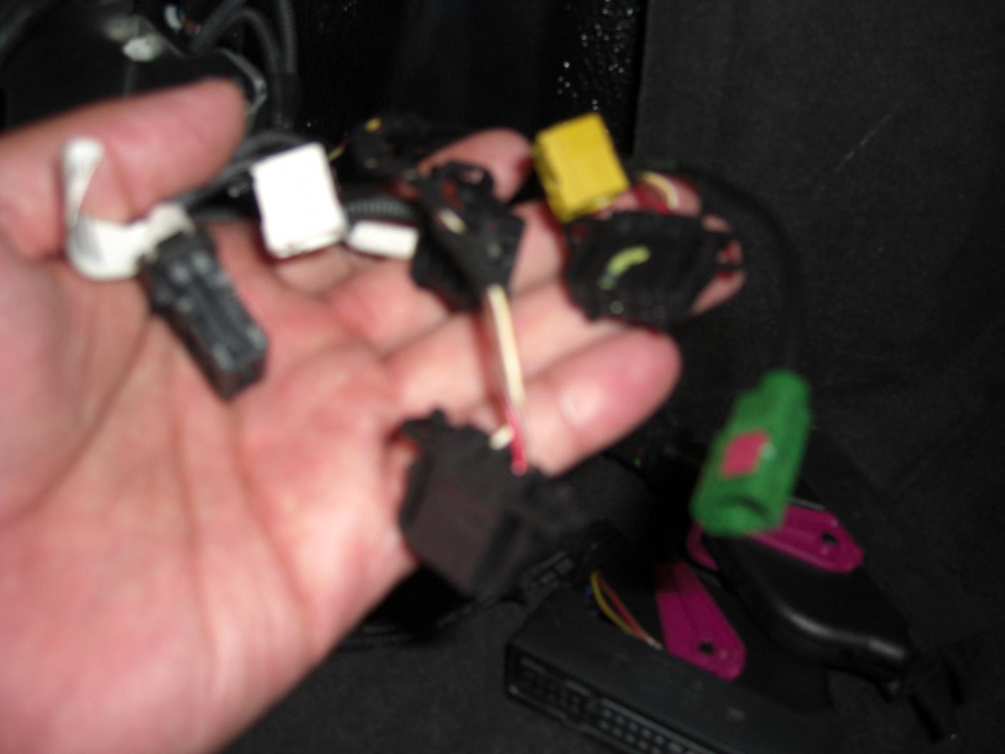

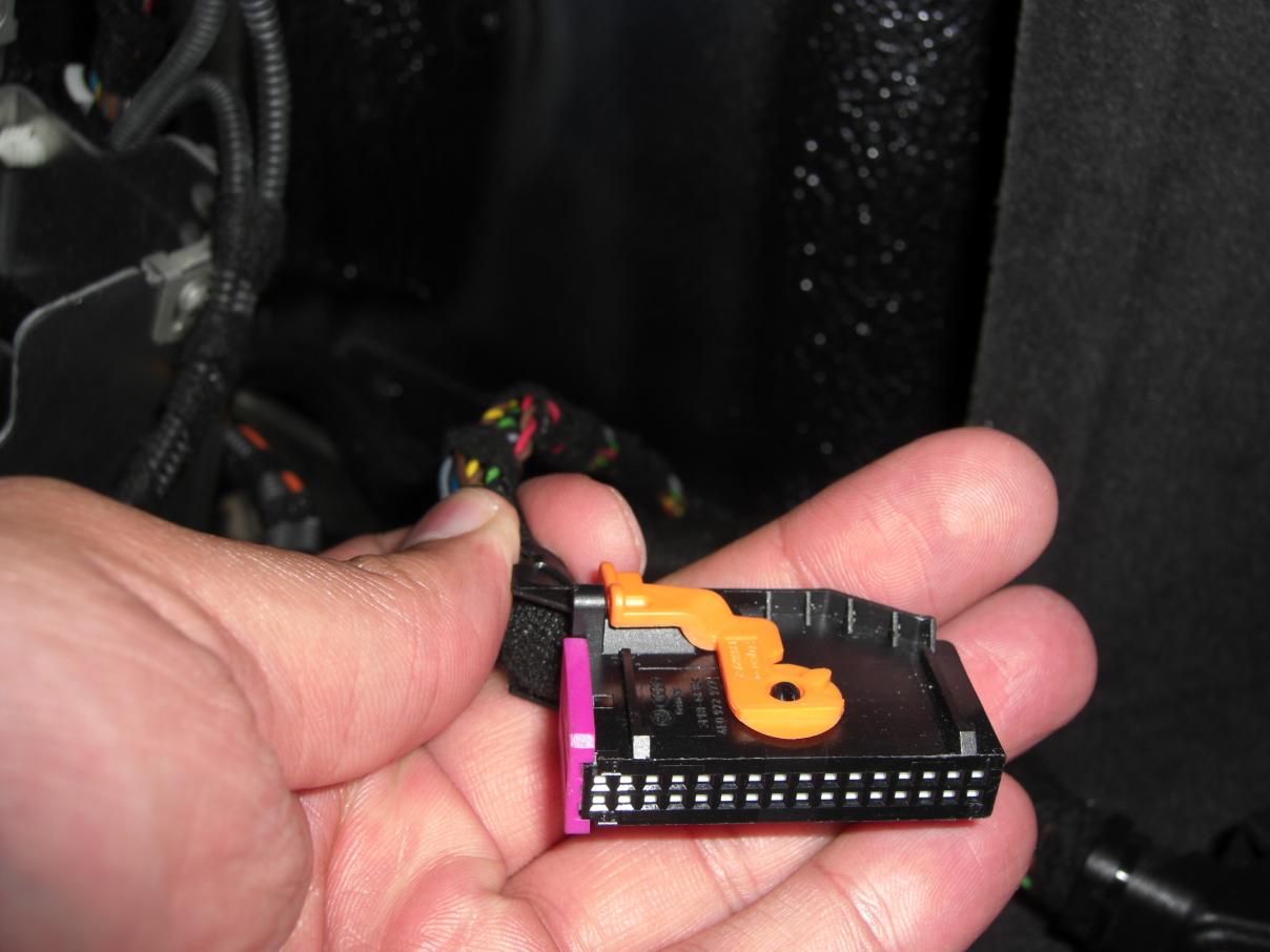

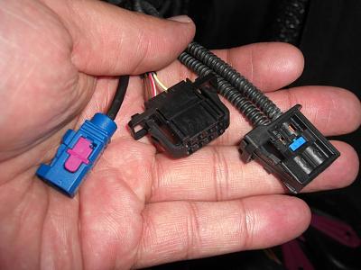

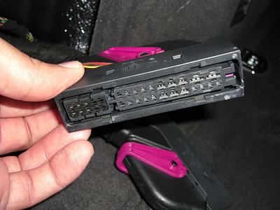

Pictures are attached with all the connections. Real question is which of the following goes there(except CD changer)
These were the part # given to us by Audi when we gave them the VIN. I don't think all are missing but we just don't know if they were in the trunk.
