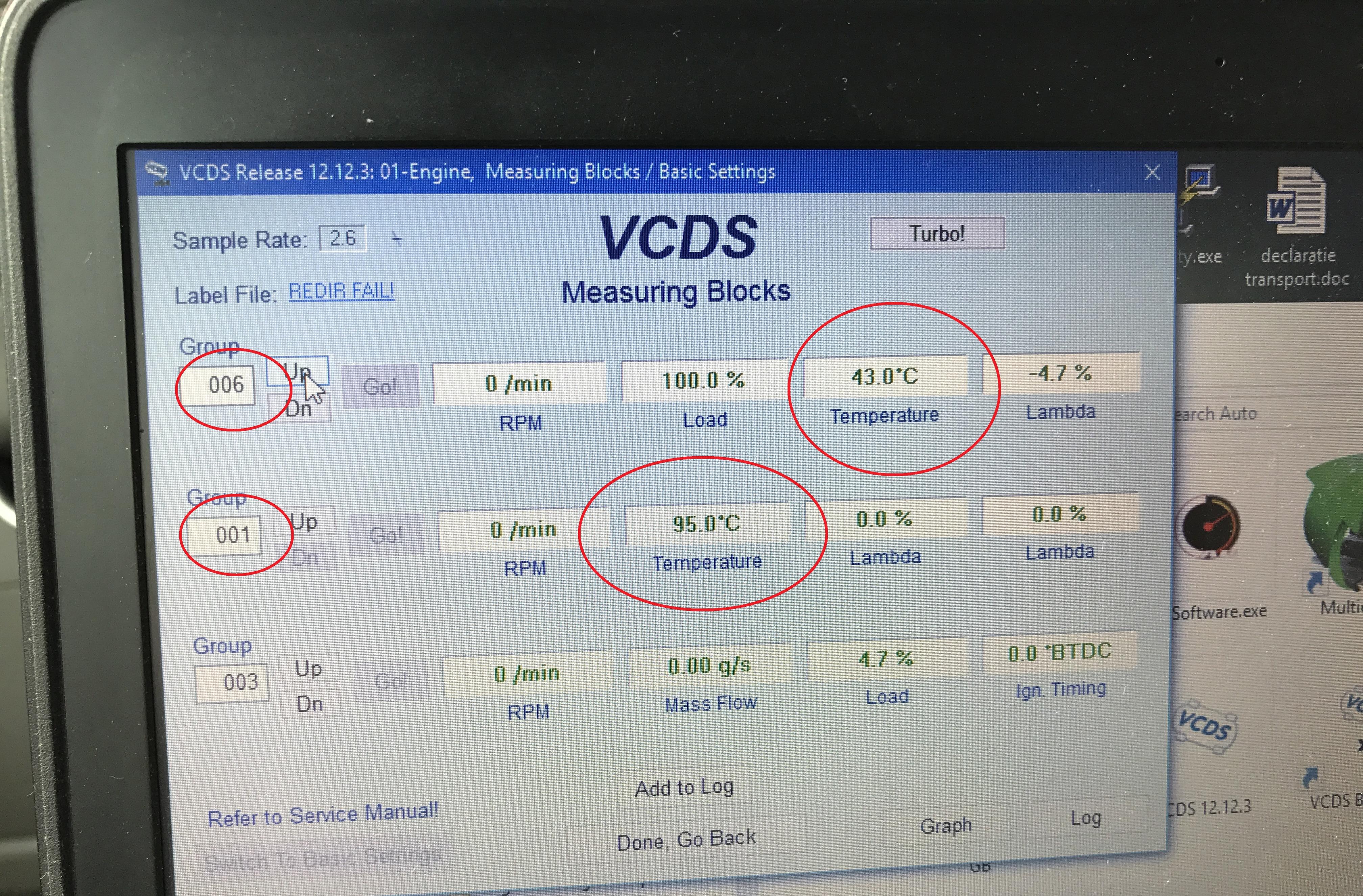

Hello,
At my 2008 Audi A8L 4.2 FSI(Engine code: BVJ) I encounter the following problems with cooling system:
Instrument gauge-------Temp VCDS Group 1 Field 2------- Temp VCDS Group 6 Field 3 -------Fan 1------Fan2--------how coolant looks in the expansion tank
80 Deg---------------------------70 Deg-----------------------------------------43-55 Deg--------------------Off--------Off---------everything normally
90 Deg---------------------------80 Deg-----------------------------------------43-55 Deg--------------------Off--------Off---------everything normally
90 Deg---------------------------90 Deg-----------------------------------------43-55 Deg--------------------Off--------Off---------The coolant level raised with 2-3mm in the expansion tank(I think it's normal)
90 Deg---------------------------97 Deg-----------------------------------------43-55 Deg--------------------Off--------Off---------the coolant just began leaking out of the expansion tank
90 Deg--------------------------100 Deg-----------------------------------------43-55 Deg--------------------Off--------Off---------the coolant is leaking a lot out of the expansion tank
* 43-55 Deg means that the temp is changing without any criteria between those values
** All degrees are Celsius degrees
I did this test at idle, with AC Off. I made the same test with heating set at "HI"(more than 26 Deg), and the coolant temp raised at max 87 Deg(on VCDS Gr. 1 Field 2) and the coolant looks good.
The problem seems to be related to the cooling fans, but something is not normal:
-in VCDS at Engine->Output test, both fans works perfect
-when I turn on AC at Low Temp(Econ off, so AC Compressor is on), both fans are NOT running.
-in VCDS at Engine->Meas. Blocks-> Group 6 Field 3 it's showing a strange temperature(43-55 Deg) when outside temp is 17 Deg and coolant is at 90 Deg
The thermostat is working well and is opening at around 90 Deg. I tested this with both returning pipes out of expansion tank
The problem in my case seems to be that the cooling fans are not receiving any start command even if coolant reach 100 Deg, and I have no error on VCDS->Engine.
Can anyone with 4.2FSI (even if is on other Audi or VW car) to test VCDS->Engine->Group 6 Field 3 to see which temp is showing there? Or anybody has any tips to solve the issue?
Thanks.

I've made a test today. I've put an 2Kohm resistor in paralel with the sensor, to fool the sensor measurements. I saw that this 2Kohm resistor is more affecting the measurements at low deg. Ex: 47 C Deg without resistor changed to 66 when I installed the resistor. 92 C Deg WO resistor changed to 98 C Deg with resistor.
I kept the resistor in place(so all values writen here are affected by resistor), and I was looking carefully at everything. I observed that the coolant is raising the level with 2-3mm starting with 97-98 C deg until 101 C deg. At 101 C deg both fans are starting at low speed(I think "speed 1" is not correct because fans are PWM controlled so they works on continuous variable speed depending on temperature) and imediatelly the coolant is getting at low degrees until 98-97 C deg and the level on the expansion tank is also getting low with about 2-3mm.
An useful information for peoples that are looking for it in this forum: at 4.2 FSI engine(257KW)(AUDI, VW, etc), the fans are starting at 101 C deg
My conclusion, is that the temp sensor is faulty and because of incorrect reading, the "protection system" is not starting.
Today or tomorrow I will order a new sensor and get back with the results.

Finally solved. The new temp sensor solved the problems. Tested with and without cap.
Without cap the coolant it's just about starting to boil and the fans are immediately starting and everything get back to normal.
With cap, everything is perfect.
I've tested old vs new sensor and the difference was really big. At 90C deg water, the old one had 254 Ohms and the new one had around 180 Ohms.
I started to investigate the problem when one of cooling system pipes was begining to leak a lot of coolant because of too high presure(with cap in place). Indeed, the presure was to high because when the fans are starting, at 101C deg in VCDS, but the real temp of coolant was actually much more deg. I can estimate that the coolant had actually about 115C deg when the sensor was reading just 101C deg.
