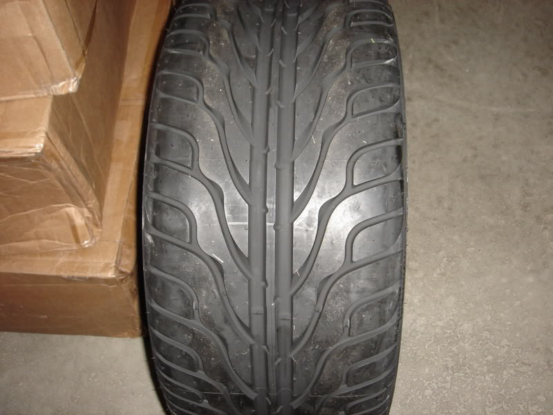

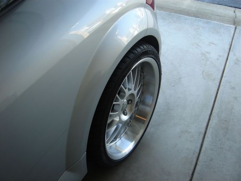

Here is a couple pics of my old wheel and tire setup. Same width wheels as yours. 8.5 front 9.5 back, I ran 235/35 in the front, and265/30 out back. (you can see from the first pic there is little to no stretch
Size:  72.8 KBName:  NewTownhouse7-2007001.jpg
