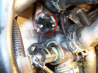

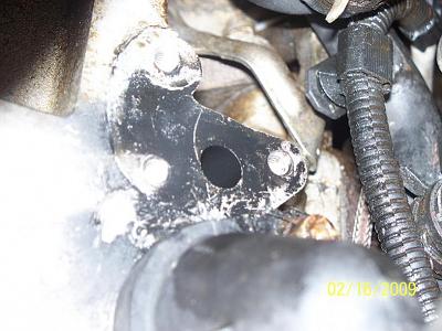

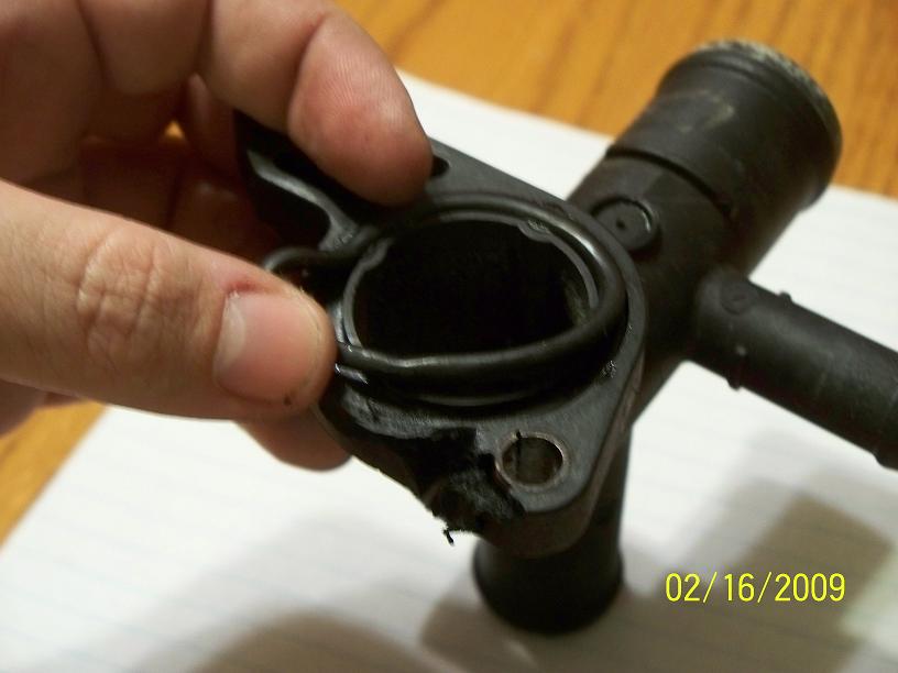

What is this piece that has been welded and blocked off on my car?
What did it attach to?
It's below the coolant temp sensor on the drivers side of the motor.
It was only fingertight and was probably what was leaking... but the housing next to it was rubbed by it and thats what the plastic shown in the other pic is.

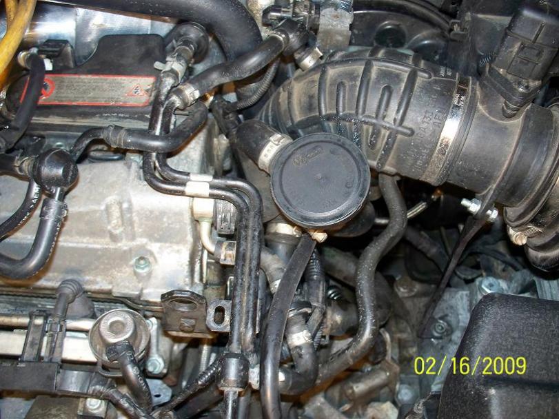

Looks like hack secondary air injection blockoff plate??? Probably had exhaust gasses leaking (looks sooty), which could have melted the temp sensor housing.
You have a combivalve and/or air pump on your car?
combi = shiny thing just below the DV in this pic

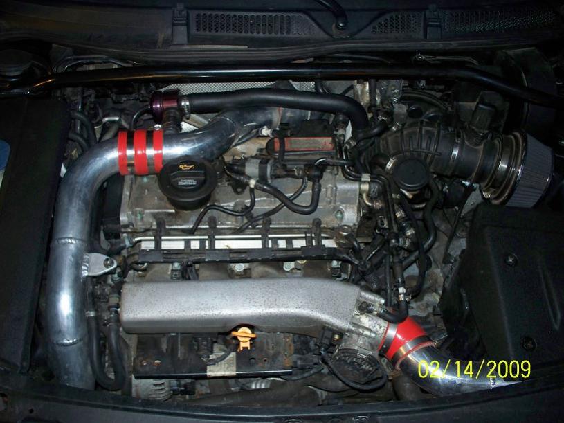

Here's mine...

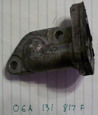

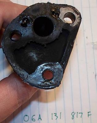

Correct sir, it was a bootleg SAI delete
( don't blame whoever did it... the plate is $35!!! )
Problem is it worked loose and the gas coming out melted through the coolant T that holds the coolant temp sensor... I couldn't believe how it ate through it.
