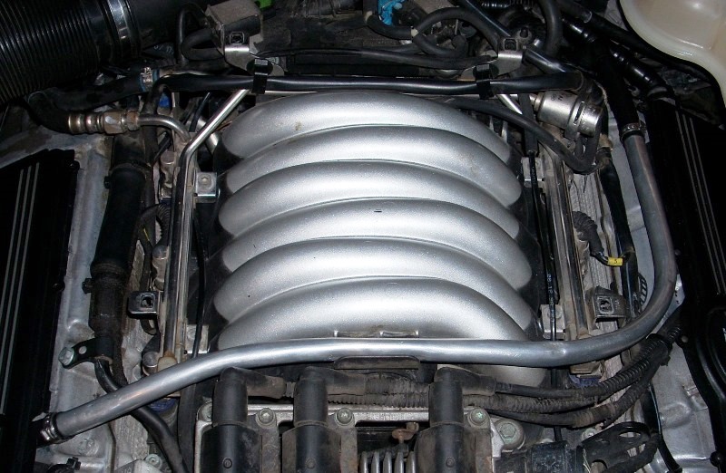

I don't know what the extension is on those codes. RossTech doesn't say anything about them. But...go back to RossTech and read the possible causes for 16684.
16684/P0300/000768 - Ross-Tech Wiki
First one is air intake system leaking. That's what your crumbled breather system is, a big leak. I'd start with shoring up that. I've been known to put it back together with heater hose and clamps. Bshusted put me on to this pipe and I completely redid mine for about $50. Looks nice and will never crumble. As long as you're doing it take off the check valves on the back of the motor and clean 'em out good with gasoline. I'm not sure this is the cyl 2 misfire, but it would certainly account for the random multiple misfires.

Yea if you want to just get it running again, black heater hose in the bad spots with hose clamps will do. Bshusted here (I'm blaming him) got me going on rebuilding the whole thing. I went to McMaster Carr McMaster-Carr and ordered pipe, plastic tubing to transition to the existing plastic connectors and clamps.
89965K273 Multipurpose Aluminum Tubing, 5/8" OD, .555" ID, .035" Wall Thickness, 3' Length 1x10.85 = 10.85
52315K251 Extreme-Temperature Tubing Made with PTFE, 5/8" ID, 11/16" OD, 1/32" Wall Thickness, Black 2' 7.86/ft = 15.72
52545K25 Gap-Free Pinch Hose and Tube Clamp, 39/64" to 47/64" Clamp Diameter Range, 9/32" Band Width, Packs of 25 1x10.83
