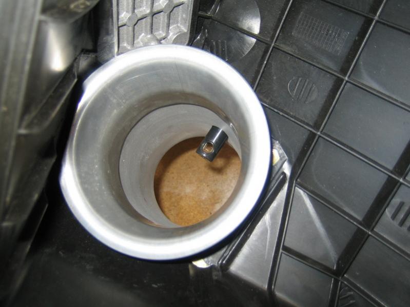

This has been done before, and can and does work with a stock airbox. If by "metal protector part" do you mean metal MAF screen?
Either way, the purpose of the metal screen is not to protect the MAF sensor, it is to straighten out the air. A Velocity stack(Bell mouth) also straightens out the air, but without restricting the intake (with obvious obstructions in the air path). The MAF needs non-turbulent air to read correctly. Without the screen, many have reported CEL's.
If yours is working with a cone filter, I would guess that internally the cone filter has a sloping edge good enough to straighten out the air. On my other car, I have an HKS intake that is designed as an advanced velocity stack with a filter on it, so it has a dual purpose.
The downside to not using the stock air-box is that without an airbox, you now have a hot-air intake once the car is up to temp. Obviously it's more cost effective to keep the stock one than fabricate a new one.
I'm glad you took the initiative to do some work to the 2.8. The 30v can breathe a lot, it just needs a little work.

Personally, I would not run it without a velocity stack. The idea is really old; see vintage carb'd Ferrari race cars with velocity stacks coming out of the hood. By managing the air, you also increase velocity. Just a bigger maf is half the deal.
As for 10-15 hp, I don't think it's out of the question if done properly. No one seems to wonder why the MAF on the 1.8t, 2.8 12v and 2.8 30v all have the same diameter MAF at 2.5"" I.D.(hint, it's cost effective). One guy actually flow tested the 30v and he said it's capable of flowing twice as much as the 12v... but it has the same diameter MAF. It's not an issue for the 1.8T as forced induction over comes the MAF size, mismatched ports etc. But I'm surprised it hasn't struck too many as why a 150 hp car has basically the same MAF as a 190 hp car. With the screen, the usable area is more like 2.12". It's not crazy to see why the car hits a wall at 4000 rpm.
I'm too busy with other crap to take pics of mine, but it's been done before by a lot of guys on Audiworld. Since their changeover, most of the pics are lost though. But the RS3 MAF upgrade is done with the stock airbox and velocity stack. There's also a bored out throttle body and silicone intake... all together it makes a sweet upgrade. Better than a 500 chip IMO. Not just hp, but response it much improved.
