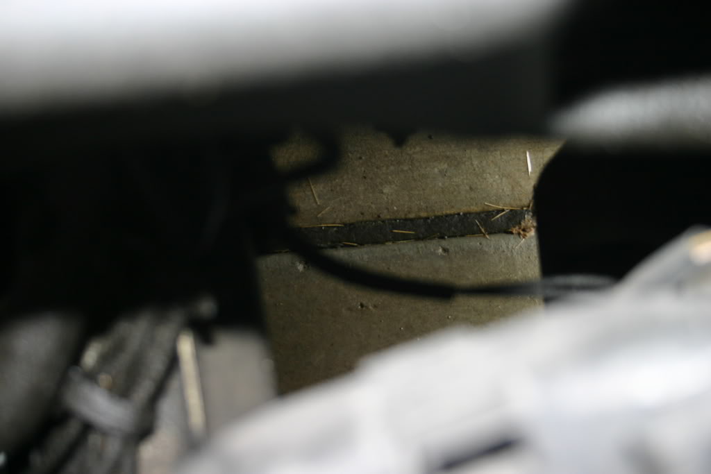

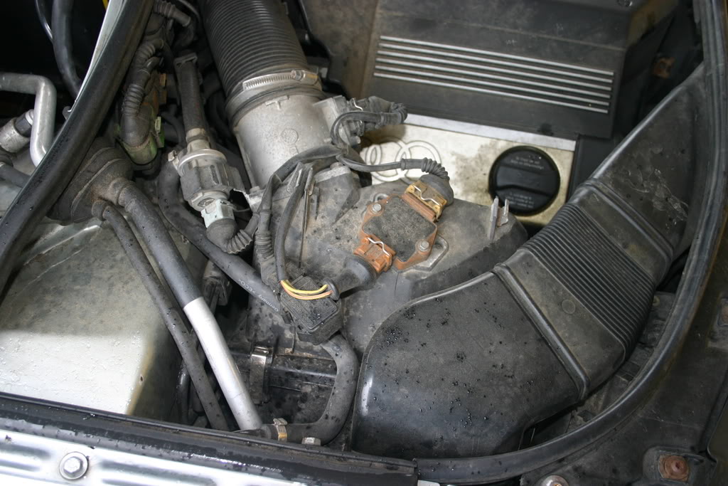

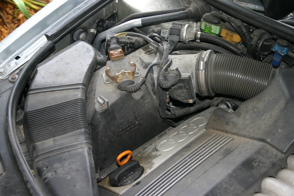

This is childs play. A turbo goes where the enormous airbox is at on the passenger side. I forgot how much space this thing takes up.

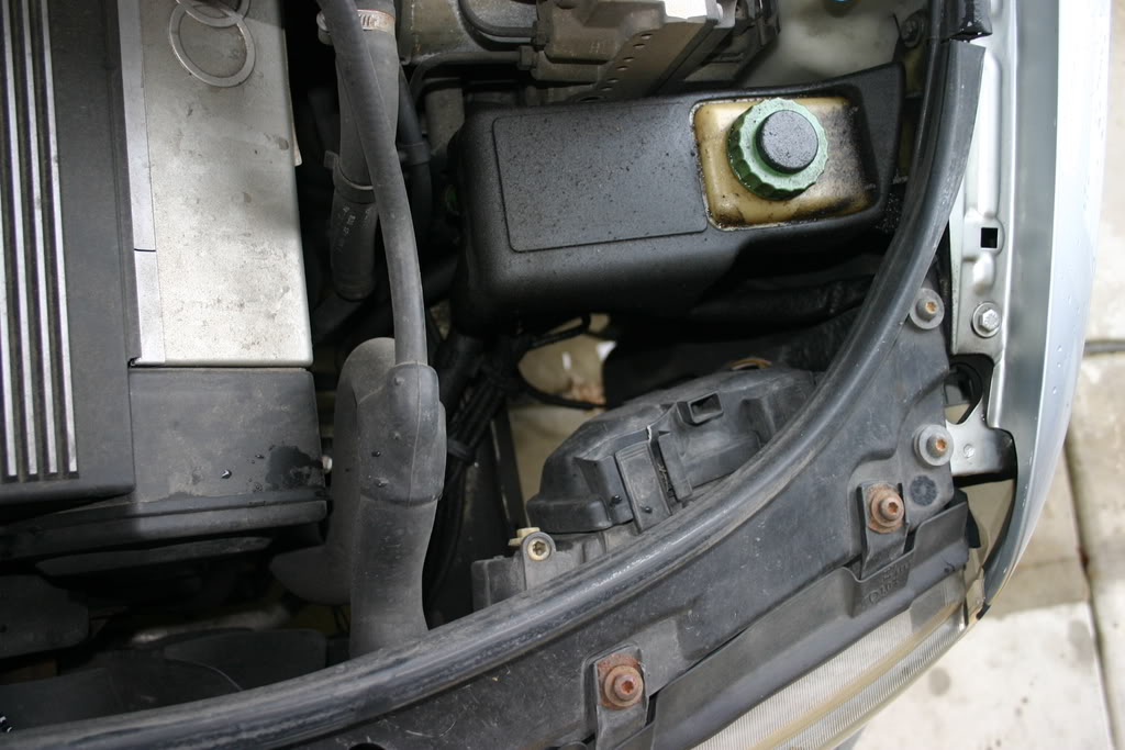

Conversely it could be put down on the drivers side down in the gaping hole behind the right side grill.

So what your saying is, I should run twin k04s and put them where the stock airbox is and right under where the power steering reservoir is. I don't need to worry about an intercooler, I can just run methanol injection and maybe a little intercooler, or just the methanol itself. Great idea supersquid but like I said earlier, something in me just doesn't want forced induction.

Where are you going to run the pipe from the other manifold?
