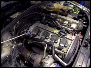

Old Jul 29, 2008 | 12:59 AM
onepoint8tee's Avatar
Site Moderator
Joined: Sep 2005
Posts: 13,664
Default RE: 2000 a4 down pipe
Tab is circled:
