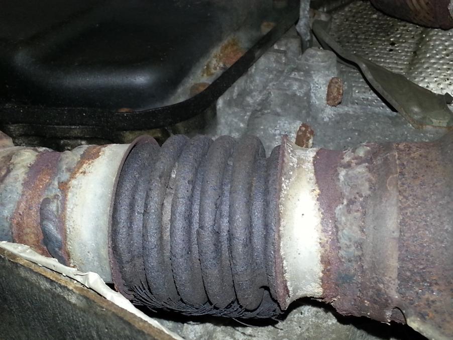

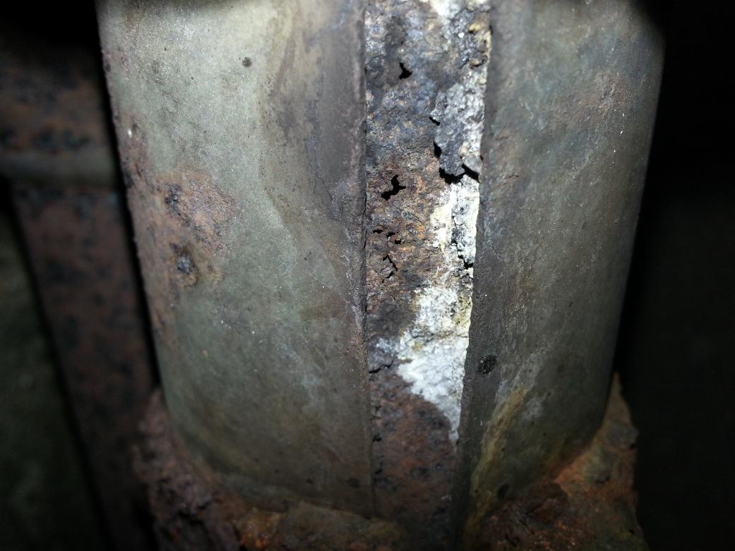

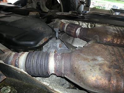

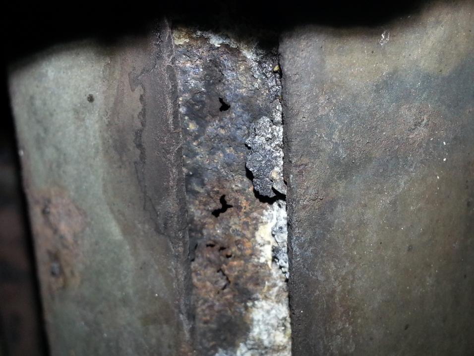

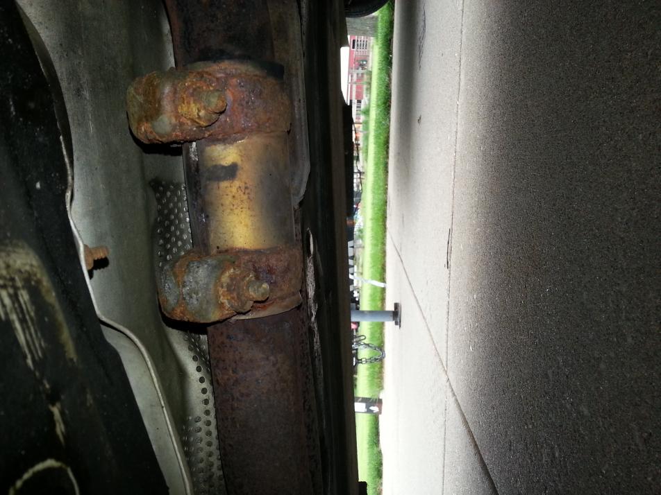

Hey all, I just recently purchased my 2000 A4 2.8L Quattro, and I really do love it. One of the few problems with it is an exhaust leak. I took a few pictures and will try to attach them onto this (first time trying to get pics on here). I am in need of advice on how to go about fixing this. The exhaust leak is bearable and isn't too loud actually. However, you can hear the "puttering" sound when driving. The first place I felt exhaust escaping from is where the clamp is on the picture. You will see it is all brittle and whatnot. However, that is not where the noise is coming from. The noise is coming up from where it looks as if it is a boot. There is a lot of air escaping from this when I put my hand up to it and it sounds like this is exactly where the noise is coming from.
My question is how should I go about replacing these? I have found clamps online to replace the one that is all brittle for fairly cheap. However, I'm not sure how to go about fixing the one main leak? Thanks for your input, I appreciate it.

For some reason the pictures all showed up upside down. Anyways, the first two pictures is where the main noise exhaust is leaking from. Im not even positive, but in that "boot" looking piece the flex pipe? Thanks for your input guys and advice on how to fix this/repair this.

It appears that both of your flex joints are toast. Unfortunately, the down pipes including the flex joint and catalytic converter are sold as a single piece and are very expensive. An alternative to replacing the entire down pipe is to find a small exhaust shop that will cut out the failed joints and weld in replacements.

Well, I called a local muffler shop and they said they would cut out the old flex pipe and weld in another one for $85 in about 30-45 min. Now, look at my first picture. Why does one look like a true flex pipe and the other one looks a boot. Is that or was that suppose to be a flex pipe also? I'm a little confused why it looks like a boot.

You need to replace both of the flex joints. The one looks different because all of the exterior wire is gone. There is an inner and outer sleeve to the flex joint.
