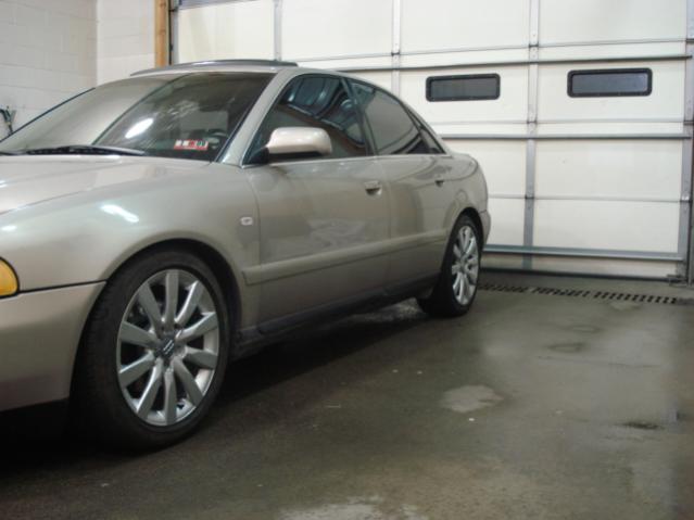

Per your recommendation I grabbed a set of 225-45-17 bridgestone potenza's. Have them on the car here in a couple hours.
Here is a pic of the car this morning as it sets with the 245-45-17 rubber on it now.
Sorry its so dirty but not much to do about it when its +3 outside and roads are nothing but salt.

Yeah, you're car is dumped in the front. Looks good though. Any rubbing issues? Did the tires fit OK on the 8" wide rims?

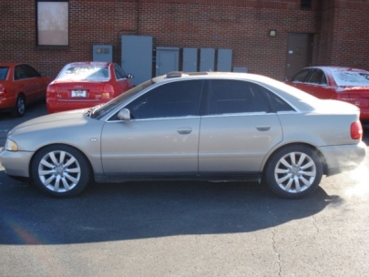

Well, so that everyone knows now, you can run B8 wheels on a B5 if you run 225-45-17 tires. We tried test fitting a 235-45-17 and again the rear tires rubbed, but very slightly so maybe not everyone will have this issue. The 225-45-17 fit like a glove. Here is an updated pic.

234/45R17 is still too large of a sidewall. You'd have to use 245/40R17 to prevent rubbing from too much height, but 245mm wide may require rolling the fenders to prevent rubbing from width.
I like the look. They look better on a B5 than a B8!
