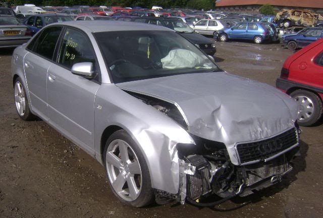

Sorry to drag this thread back up but did you guys know the Euro B6 190bhp S-Line (I Got one) come with twin SMIC standard already fitted.
Here a crashed S-Line I was looking to buy untill I found out it was FWD but you can see the SMIC on the left.

Nuespeed makes a twin SMIC set for round 1k. I haven't read this whole thread yet but it doesn't create as much lag as you'd think. The air mass flows great on it and is a good upgrade but since its more restricted of airflow it still won't produce the effects of an FMIC. I'd just get a FM and put DIY plasti-dipped mesh to keep it hidden

Are you sure that Nuespeed kit isnt for the GTI/Jetta? The stock ic flows like crap! Have you ever seen inside of them? Adding another would only get you minor results since the flow change would offset the cooling.
If people want a simple install, there are few upgraded smic's available that will slide right in. However, they are just as much if not more than a ebay fmic kit which would probably give the same results.
