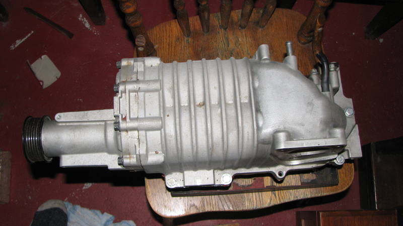

Sorry about dissapearing. Finals are just about done and work is off my back now. The block is back, all cleaned up, valves are in the heads, still need injectors. I'm thinking about chopping the k03's and grabbing a single GT since spool time won't be such a big issue with the m90. Here it is btw Hopefully after the time to figure out what I'm gunna do for a crank. The 3.0 crank is 2 bolt mains? I'll have to deal with that it looks like.
